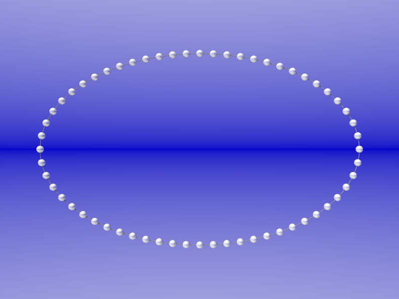

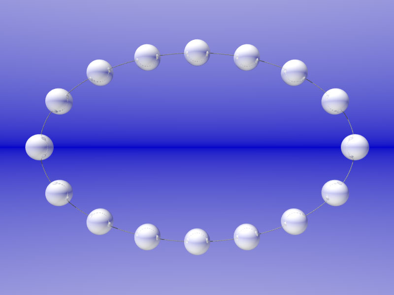

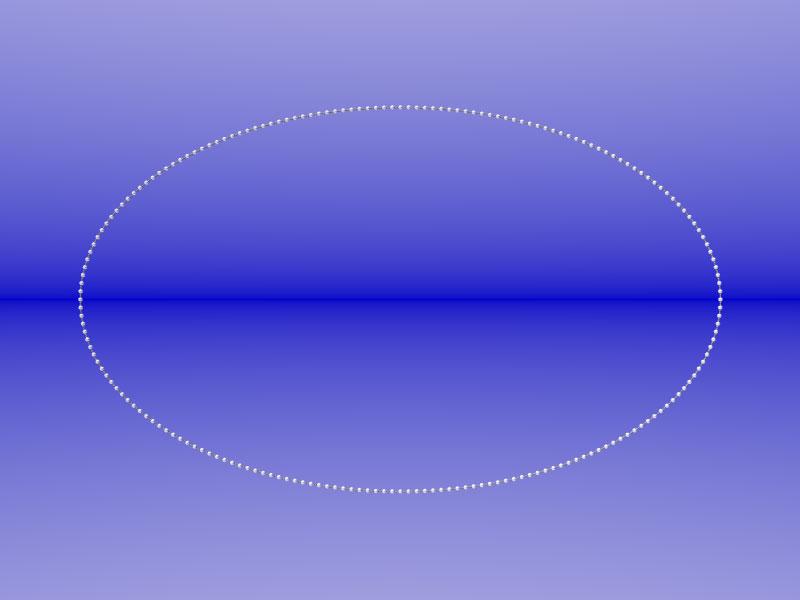

I had no time to search algorithm for distribution points on elipse
therefore I quickly prepare some method to find them.
Perhaps it can be useful for somebody for example in
camera movement, with oval buildings or with some abstract creation.
Perhaps it can be extended with other shapes.
images -> p.b.i      (for nseg=4,15,50  ~ 82,6 KB)
source -> p.b.s-f
ABX
Download 'aprox04.jpg' (31 KB) Download 'aprox15.jpg' (28 KB) Download 'aprox50.jpg' (25 KB)
Preview of image 'aprox04.jpg'
Preview of image 'aprox15.jpg'
Preview of image 'aprox50.jpg'

From: Rune
Subject: Re: selfaproximation
Date: 21 Jul 2000 20:06:17
Message: <3978e579@news.povray.org>
"Josh English" wrote:
> There is an easier way to do an ellipse:
ABX's method distributes the spheres *evenly* along the ellipse.
Greetings,
Rune
Updated July 10: http://rsj.mobilixnet.dk
3D images, include files, stereograms, tutorials,
The POV Desktop Theme, The POV-Ray Logo Contest,
music, 350+ raytracing jokes, and much more!
