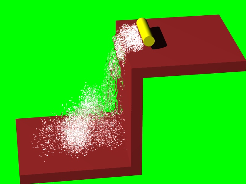

I was fooling with Chris Huff's particle stream patch and got this far
before deciding to give up.  Looks like it has possibilities.  (Jpeg
compression was not kind to this image.)
Download 'waterfall.jpg' (81 KB)
Preview of image 'waterfall.jpg'

How long did that picture take to render?
Brendan
From: Mike Wilson
Subject: Re: Particle Waterfall Test Image
Date: 10 Jul 2000 17:54:24
Message: <396A45FB.978B8245@iastate.edu>
About 4.5 hours on a 300 Mhz PII.
Mike

Oh, my God, that looks beautiful... I was just about to start work on one
myself. Could you please post the source?

>(Jpeg compression was not kind to this image.)
That's because of the green and red.

Hmmm, I wouldn't expect this to have started with white frothy water were it
just meant to be the beginning of flow.  So it looks like it's under pressure
and spraying out from the cylinder.  The dynamic look to it is fascinating to
see in a POV-Ray render.
A regularly patterned texture backdrop might have been able to show the water
better, since it has refraction.

Agreed.  This image doesn't quite correspond to my original idea.
I had planned to to put the source further "upstream" and just give the particles
enough push to reach the edge of the dropoff and let gravity take over.  I had
thought that a low elasticity and small environment collison factor would make
them flow along the top of the falls, but apparently the particle system doesn't
work quite like that.
The particles just dropped right through the falls object unless I gave them a
fairly significant downstream velocity (equal to gravity) and made the collision
factor fairly large.  As it stands now, the particles are already within the
collision zone as they exit the emitter.  Gravity and intial velocity drive them
into the falls object at a 45 degree angle where they immediately collide.  Since
elasticity is set fairly high, they bounce back up again and go over the edge.
(At least I think that's what's happening.)  It might look ok if there was a rock
or something there that would justify this, but as I said, this was just a test.

Thanks for the explanation.  I hadn't thought about it being both a momentum
plus bounce for what it looked like at the top edge of the waterfall.

The next version will have a more precise collision algorithm, which
should fix this. It also eliminates the need for a collision distance
parameter.

That'll be great.  I really like this patch.
