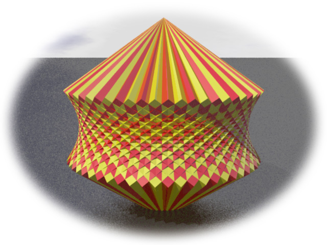

Hi all...
recently I was confronted with a bit of a brain teaser:  When a cube is spun
about the axis of it's two opposite corners what is the shape of the space
it passes through?
I had a few bright idea's.. some of them pretty accurate.. but before long I
decided to test the result.
The resulting shape is fairly intriguing so I thought it may be worth
sharing.
BTW.. just try placing a POV cube so that two opposite corners lie on the y
axis. It's trickier than it sounds.
Ian

A kind of amusement park carousel ride object.  If you make that with filtered
color and give it a ior I'd bet it would take 100 times longer to render, if
not more  :-)

Looks like a circus tent...
And is that one of my post_process filters you used to make the circular
image? Maybe multiply and add with a spherical/wood/onion/cylinderical

: BTW.. just try placing a POV cube so that two opposite corners lie on the y
: axis. It's trickier than it sounds.
  It requires some math.
  One may think that just rotate 45 degrees around x axis and then 45 degrees
around z axis, but one will soon discover that it's not so easy (when trying
to render it).
  The first step was right: rotating 45 degrees around the x axis makes the
diagonal to lay on the x-y plane. Now we only need to rotate it around the
z axis so that the diagonal is parallel to the y axis.
  The reason why 45 degrees is not correct is because the diagonal
is not 45 degrees from the y axis anymore. This is because now the diagonal
is higher than it's wide.
  More precisely the diagonal is 2*1 units wide while it's 2*vlength(<1,1,0>)
units high (supposing we have a -1,1 cube).
  The degree is precisely asin(width/length), ie. asin(1/vlength(1,1,1)).
  Now we only have to translate the box up so that the corner will be located
at the origin. Since we have the length of the diagonal (2*vlength(<1,1,1>)),
that's easy.
  In povray code it will be:
camera { location <-2,4,-10> look_at y angle 35 }
light_source { <100,200,-300> 1 }
plane { y,0 pigment { checker rgb 1, rgb .5 } }
box
{ -1,1 pigment { rgb <1,1,0> }
  rotate x*45
  #declare len = vlength(<1,1,1>);
  rotate z*degrees(asin(1/len))
  translate y*len

Ooh, sounds easy...
Bah, rotate <0,45,degrees(asin(1/sqrt(3)))-90> should do it.
Okay, i'll stop ;)

You could have just asked what a spun cube looked like.  Anyone who's
ever played roleplaying games (AD&D (Yech!), Call Of Cthulhu, Runequest,
etc.) and gotten bored would have been able to tell you that the answer
is a SOR with a profile of a sort of waisted equilateral diamond.
Well, that made no sense.  Go find a six sided dice, and spin in on a
flat surface.  It'll probably take a hell of a lot longer than it took
you to do the maths, write the scene file and render it...
<grin>
Oh, and I figured it out using a pencil, paper and calculator, and the
rotations I came out with were <45.0,0.0,35.26439>.  This was using
nothing more complicated than basic trigonometry and Pythagoras' theorem.
Bye for now.
     Jamie.

I will not tolerate imperfection! Rotate <45,0,asin(1/sqrt(3))> ;-)

okay okay.. as so many of you have pointed out it isn't all that tricky
after all <hangs his head in shame> :-(
