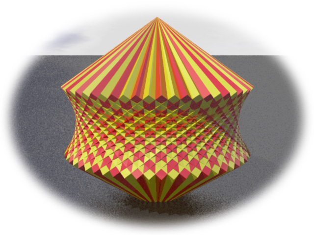

recently I was confronted with a bit of a brain teaser:  When a cube is spun
about the axis of it's two opposite corners what is the shape of the space
it passes through?
I had a few bright idea's.. some of them pretty accurate.. but before long I
decided to test the result.
The resulting shape is fairly intriguing so I thought it may be worth
sharing.
BTW.. just try placing a POV cube so that two opposite corners lie on the y
axis. It's trickier than it sounds.
Ian

A kind of amusement park carousel ride object.  If you make that with filtered
color and give it a ior I'd bet it would take 100 times longer to render, if
not more  :-)

Looks like a circus tent...
And is that one of my post_process filters you used to make the circular
image? Maybe multiply and add with a spherical/wood/onion/cylinderical

No, I used Adobe Photodeluxe... I guess I can't enter this in the irtc :-)

You could have just asked what a spun cube looked like.  Anyone who's
ever played roleplaying games (AD&D (Yech!), Call Of Cthulhu, Runequest,
etc.) and gotten bored would have been able to tell you that the answer
is a SOR with a profile of a sort of waisted equilateral diamond.
Well, that made no sense.  Go find a six sided dice, and spin in on a
flat surface.  It'll probably take a hell of a lot longer than it took
you to do the maths, write the scene file and render it...
