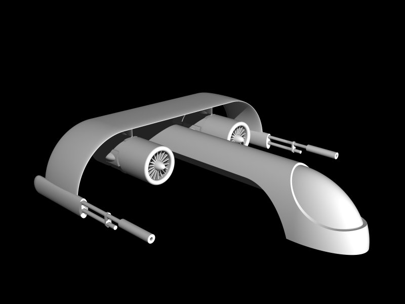

Here's a little (untextured, at the moment) pic I'm working on (using
Moray 3.2 & PovRay 3.1g).  Any comments/criticisms would be greatly
appreciated.  Thanks in advance.

Looks remotely similar to a drawing I made once of a thin atmosphere aircraft,
had larger turbines than this but were mounted as part of the wings.

Looks more like a toy, dunno if thats because of the texturing, but it just
strikes me as that

Nice... Looks like it would fly... Maybe the wings need to be longer in span
for better lift... Looks like you need flaps for control and some type of
rudder too... Very good concept stage... :)
