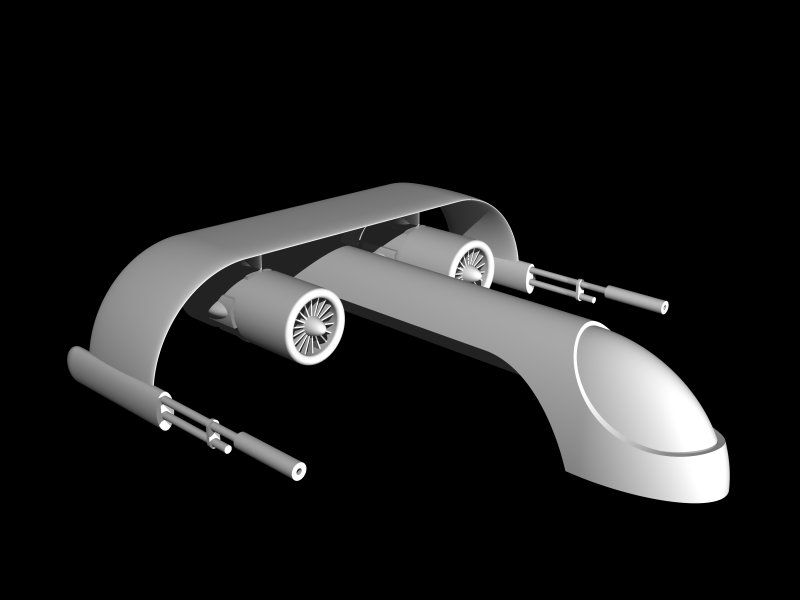

Here's a little (untextured, at the moment) pic I'm working on (using
Moray 3.2 & PovRay 3.1g).  Any comments/criticisms would be greatly
appreciated.  Thanks in advance.
Hookflash
P.S. I'm having trouble lighting my scenes... What are the most common
methods used (I remember hearing something about "3-point lighting",
whatever that means)?

Looks remotely similar to a drawing I made once of a thin atmosphere aircraft,
had larger turbines than this but were mounted as part of the wings.
The lighting rule is basically 3 lights, one behind and up some, one above and
to the side, one below.  I think that's it anyhow; of course the intensities
vary too, the main light being above and one side.
There's a web page someplace telling about it but I can't find the link now.
It's not for every scene you ever create, I think anyone will tell you that.

Looks more like a toy, dunno if thats because of the texturing, but it just
strikes me as that

Here's what I usually use for showing off a model:
#declare Brightness = 1; // tweak to fit;
// #declare High_Quality = on; // uncomment if needed
light_source
{ <0,100,0> color White*0.5*Brightness
  #ifdef (High_Quality)
    area_light
    20*x, 20*z,
    5, 5
    adaptive 1
    jitter
  #end
  spotlight
  point_at 0
  radius 5
  falloff 13
  tightness 100
light_source
{ <100,100,-100> color rgb <1,0.9,0.8>/2*Brightness
    area_light
    15*sqrt(2)*(x+z), 30*x,
    5, 5
    adaptive 1
    jitter
  #end
light_source
{ <0,40,60> color rgb <0.8,0.9,1>/2*Brightness
    area_light
    10*sqrt(2)*(x-z), 20*x,
    5, 5
    adaptive 1
    jitter
  #end
  spotlight
  point_at 0
  radius 5
  falloff 15
  tightness 10
Seems to work OK for models that fit a sphere { 0, 10 }.

Nice... Looks like it would fly... Maybe the wings need to be longer in span
for better lift... Looks like you need flaps for control and some type of
rudder too... Very good concept stage... :)
