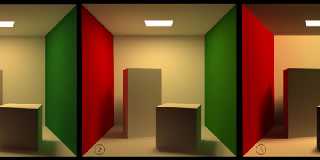

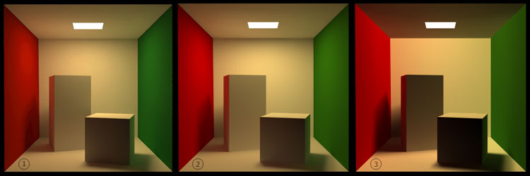

My empirical studies with MegaPOV radiosity have shown that it
works as advertised. There are some other factors that are more
important for realism than the radiosity settings.
1. assumed_gamma & Display_Gamma
   These parametrs relate only to the CRT and have nothing to do
   with simulating light transport and should be taken out of
   the simulation by using assumed_gamma 1.0. Display_Gamma should
   be set to a value correct for the particular monitor.
2. Light source intensity distribution
   In real life there are no omnidirectional light sources. By this I mean
   that all ligh sources have some charachteristic intensity distribution.
   In this scene the light source is a flat square panel. It's projected
   area decreases by cos(angle) and so does it's brightness. For this reason
   just using area_light isn't enough because it still radiates in all
   directions with equal intensity (see fig.3). I used spotlight to simulate
   this cosine falloff. (tightness 0 produces cos(angle*2)/2+0.5 intensity)
3. fade_power
   In real life light source's apparent brightness follows 1/r^2 equation.
   The correct value for fade_distance seems to be 1.4*light_source_diameter.
All three factors must be taken into account if relism is the goal.
As proof I present 3 images (gamma 2.2):
  1) The Cornell reference image.
  2) MegaPOV 0.5 image rendered with with:
       assumed_gamma 1.0, Display_Gamma=2.2
       spotlight modifier
       fade_power 2
     This is a nice match with basically the default MegaPOV radiosity settings.
     All texture and radiosity parameters within nominal range.
  3) The same scene with same settings without:
       assumed_gamma
       spotlight modifier
       fade_power
     (Texture and light colors gamma corrected)
      This is a typical 1st attempt at radiosity. Too much color bleed,
      not enough diffuse light, flat shading.
Once again, the difference between images 2 and 3 is caused by
assumed_gamma, spotlight and fade_power. Source to binaries.scene-files
by Monday.

And your images prove your words. Impressive work!
My only concern is fade_power, shouldn't you use 1000?

To Popov:
This 1/r^2 attenuation is purely geometric and has nothing to do
with media interaction.

Actually, the equation that POV uses for light attenuation is a good
approximation.  Interior attenuation, however, is simulating a totally
different phenomenon, and therefore _should_ be using a totally different
equation.  However, in the official POV-Ray, it uses the same equation.  The
fade_power 1000 "hack" just tells POV to use a different equation to produce
more realistic results. That equation, though, would not work for simulating
light attenuation caused by the energy spreading out over a larger area as
distance increases.
