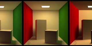

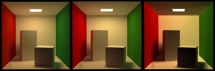

My empirical studies with MegaPOV radiosity have shown that it
works as advertised. There are some other factors that are more
important for realism than the radiosity settings.
1. assumed_gamma & Display_Gamma
   These parametrs relate only to the CRT and have nothing to do
   with simulating light transport and should be taken out of
   the simulation by using assumed_gamma 1.0. Display_Gamma should
   be set to a value correct for the particular monitor.
2. Light source intensity distribution
   In real life there are no omnidirectional light sources. By this I mean
   that all ligh sources have some charachteristic intensity distribution.
   In this scene the light source is a flat square panel. It's projected
   area decreases by cos(angle) and so does it's brightness. For this reason
   just using area_light isn't enough because it still radiates in all
   directions with equal intensity (see fig.3). I used spotlight to simulate
   this cosine falloff. (tightness 0 produces cos(angle*2)/2+0.5 intensity)
3. fade_power
   In real life light source's apparent brightness follows 1/r^2 equation.
   The correct value for fade_distance seems to be 1.4*light_source_diameter.
All three factors must be taken into account if relism is the goal.
As proof I present 3 images (gamma 2.2):
  1) The Cornell reference image.
  2) MegaPOV 0.5 image rendered with with:
       assumed_gamma 1.0, Display_Gamma=2.2
       spotlight modifier
       fade_power 2
     This is a nice match with basically the default MegaPOV radiosity settings.
     All texture and radiosity parameters within nominal range.
  3) The same scene with same settings without:
       assumed_gamma
       spotlight modifier
       fade_power
     (Texture and light colors gamma corrected)
      This is a typical 1st attempt at radiosity. Too much color bleed,
      not enough diffuse light, flat shading.
Once again, the difference between images 2 and 3 is caused by
assumed_gamma, spotlight and fade_power. Source to binaries.scene-files
by Monday.
_______________________________________________________________________
Kari Kivisalo                                          www.kivisalo.net
Download 'realistic.jpg' (26 KB)
Preview of image 'realistic.jpg'

And your images prove your words. Impressive work!
My only concern is fade_power, shouldn't you use 1000?
Peter Popov ICQ : 15002700
From: Kari Kivisalo
Subject: Re: Realistic radiosity (30k)
Date: 10 Jun 2000 16:45:14
Message: <3942A94A.91026DB2@kivisalo.net>
I'm pretty sure that every physics book I have red says 1/r^2.
You must be thinking about interior fade_power :)

I wouldn't question your physics books because mine read the same
<grin>. It escaped me that realistic attenuation is only suppoted for
object interior. But then, isn't light fading unrealistic in this
case? Can you try placing the whole scene in a transparent object and
using realistic attenuation?

I posted realistic.pov with some comments to binaries.scene-files.
Tweaking the radiosity block has only minor effect to the overall scene.
To Popov:
This 1/r^2 attenuation is purely geometric and has nothing to do
with media interaction.
From: Nathan Kopp
Date: 13 Jun 2000 00:48:08
Message: <3945bd08$1@news.povray.org>
Peter Popov <pet### [at] usanet> wrote...
Actually, the equation that POV uses for light attenuation is a good
approximation.  Interior attenuation, however, is simulating a totally
different phenomenon, and therefore _should_ be using a totally different
equation.  However, in the official POV-Ray, it uses the same equation.  The
fade_power 1000 "hack" just tells POV to use a different equation to produce
more realistic results. That equation, though, would not work for simulating
light attenuation caused by the energy spreading out over a larger area as
distance increases.
