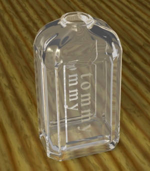

I got bored and wanted to model something new, something fresh (no pun
intended) and though the structure isn't that complex thought that it would
be quite a task for myself, which it was the main being making good glass.
I hope to eventually put water into it, but I can't be bothered at the
moment its not top of the priorities.  My major aim is to get the glass
looking good, I taught myself the basics of photons, got bored waiting for
low res, low quality test renders with little difference and gave up (though
I know how nice they can be!!).  Anyway I've just looked back my texture was
ior 1.5 (is that good or bad?), pure white (ie full colour) and filter 0.85
(I wanted to actually see it, was this a good idea), transparency 0 (I dont
understand the different between filter and transparency), ambience 0.6
(though the glass in the library had this on 0, I thought that looked silly)
diffuse 0 etc etc.  Anytips on improving the texture and/or the 5 hour
rendering time (at 800*600).  All comments appreciated
Peter Cracknell
www.petecracknell.co.uk
Download 'tommyone.jpg' (65 KB)
Preview of image 'tommyone.jpg'

Good model.
0.85
dont
Filter means that the light that goes through it will have the objects
color.  transparency means the light will remain in its original color.
(Filter is better for glasses)
ambient of .6 seems a little high.  an ambient of 0 gives the glass a more
realistic look if the lights are well positioned.   Also, give it some
reflection (like .2)  You might want a transparency of .9 or higher.
Photons would make a major difference in this.  try givining it about 2000
photons shot.
I'm not very good in photons myself, so if anyone else could help???
That's all I can think of.
BTW, how was it modeled??

Ta, I'll have a little play with those settings and maybe even photons again
(I use Moray, its annoying exporting to use MegaPOV features).  It was
modelled in SPatch, I think that between Spatch and Moray almost anything
can be modelled (except recursive objects, which is done in POV or good
animation, which from my experience just isn't done at all)

The writing on the backside of the bottle should be reversed, but other than
that it looks great.
-Doug Eichenberg

Thats weird, the image I'm working on has the word Tomy in it, no
other words, and the word will be seen through glass.
Nice work. You need to do something interesting with it, it's great
modelling (or coding), but it doesn't seem to say anything sat there
by itself.

I think it looks fine the way it is, even if somewhat different because that's
often a part of the "art" behind this stuff.
Basically what you've done there causes the background to appear washed out
more.  This reminds me of an aged glass, minus the imperfections of color
change and surface normals which would be seen.
 I'll often use pigment colors greater than 1 instead of using the ambient.
| Andre <nania> wrote in message news:393c216a@news.povray.org...
| > photons shot.
If not photons at least caustics >1.

For glass, I usually give it ambient 0, a bit of diffuse (around 0.3) and some
brilliance (2-4), plus specular etc. IOR 1.5 is OK for glass, sometimes light
fading helps too.
There isn't much you can do about the render time, reflecting glass is
notoriously slow to render.
Margus Ramst

I remember my main reason for making the posting - my main problem.  If you
look at the image closely you will notice that the tommy image (after
learning how to texture using image maps and layers) is shown four times -
yes four.  I made the model within Spatch, copied, shrunk and reconnected,
making one full model, ie
n       n
| |      | |                <-- image projected
Well sorta like that making if you imagine looking from the right (or left)
the image be shown four times, as I made a sorta thickness.  I'm sure its
been mnetioned in the past but how do I make the image be shown just once,
any ideas?
Pete

take a look at the following page:
http://www.spiritone.com/~english/cyclopedia/bottle.html
Josh.

had a quick read, seems perfect, thanks a load!
Pete
