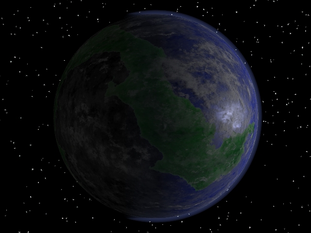

i have lowered the clouds and made them whiter.  i have reduced the
atmosphere height and made it lighter overall.  the dark side is now
dark.  i'm wondering why the top and bottom center of the atmosphere is
well lit, but the right center isn't.  would that be a scattering
problem or an absorption problem?  or color intensity?  i used Darcy's
tutorial for the atmosphere.  at the scale i'm using (7200), i had to
change the first scattering density entry to [rgbf<.1,.1,.1,1>] or it
wouldn't show up. the address of Darcy's tutorial can be found as a
responce to my previous post.

okay, i checked some other light angles and the atmosphere looks fine in
the middle right.  so i think i'll just choose my light sourse
judiciously.

Seemed more an illusion, the difference in overall brightness of the regions
might make the top and bottom appear brighter than it actually is.  You say it
changed according to light angles but if it's scattering type 1 there
shouldn't be a change in a uniformly shaped media.  Type 2, 3,4 or 5 can.
To me the planet and clouds are still dark on the lit side.  Clouds being
about a rgb 0.5 average.

I agree with Bob that what you saw before was just an illusion due to the
contrast between the atmosphere and the planet. Where the planet is fading
away, the atmosphere looks brighter, when compared to where the planet is
well lit.
