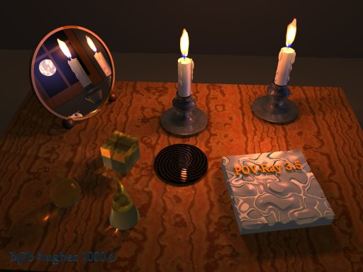

Thanks to Marc-Hendrik, after seeing his rendering, I too am trying a
candle lit scene.
Figured I'd shamelessly plug the upcoming version of POV-Ray while I was
at it, putting it as a book(?) on the table.  Not really a book, just
thinking about it.  Anyway, there are 3 glass primitives which use both
photons and color dispersion.  The lights (Moon and candles) have color
maps from a macro taken out of Prism.inc, one of the demo files, and
color-changed a little to suit the lights.
I had used the soft glow post process on this and neglected to switch
from the Png format I always output to, so no soft glow  :-(
Hope you all like it anyhow.  If not I'll be rendering it some more,
just give me a chance  :-)
P.S. to Marc-Hendrik.  I thought of an idea for that dusty look.  Maybe
layer on a semi-transparent gradient y color map texture which would
appear to have dust on the uppermost parts of objects.

Very nice on the eyes, Bob. I like the translucent appearance of the
candles, how did you manage it? I thought gradient y at first, but am not so
sure. Media?
Those little objects on the table are neat. Are those photon-mapped caustics
from the glass objects?
About the dust idea: what about using 'trace' to place a bunch of particles
on the tops of things. Or a less memory-intensive way would be to use the
slope pigment. Both of these ways would require MegaPov, though.

Very nice. I'm curious about your mirror finish: it seems to dissipate light
around the candles.
If I was to criticize; the shadows look a bit bright and the candle lights
have somewhat sharp edges.
sig

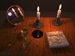

Silly me, I should have searched better for the filenamePP.png output
from post processing.  I found that file, but not before I made minor
changes and rerendered at a smaller resolution.  Checked the
documentation and no mention of changes about the added Png support or
file name change it does.  I remembered talk of it around here though.
Well, here's the previous unknown rendering this time.

Thanks a bunch, the soft glow one might bother the eyes but it's better
in a way.
Keen perception, right the first time, simply gradient y texture map
having more ambient toward tops.
caustics
Yep, photons to go along with the POV-Ray 3.5 shown in the picture  :-)

  Nice image, Bob. Did you put a normal on that table top? Looks good
that way.
  I would have expected a little bit more light reflected onto the table
from the mirror and candles due to photons but maybe it has to do with
the angle of the mirror or the relative brightness of the table.

I was happy the way that turned out, thanks.  I wanted it to do that but
it was still guesswork.  So what I did was to use a non-black pigment
and diffuse >0 plus a specular highlight but I really couldn't say what
caused it most.  There was no need to make any adjustment.
lights
Criticize all you want.  There is a shadowless light having the color of
the candle light except dimmer, maybe not dim enough.  Keep in mind
there is also Moonlight coming in at a shallow angle from the right side
too, however I couldn't say for certain whether all this light is the
cause for lack of darker shadows rather than ambient in the table and
room.  I suspect it's a combination.
About the sharpness of the candle flames, don't get me started on that.
Do you realize how long I tweaked on just those flames?!  ;-)  Seriously
though, I doubt I could change them much without finding myself with
very different and unwanted flames.  But good to hear your opinion.
| that way.
Thanks, it's pretty simple, turbulent wood pigment + normal.
table
Well, you noticed the worst part about this thing.  Metallic objects
refused to show photon caustics.
Actually I had the spiral patterned disc at center showing a shininess
onto the table at upper right side during one point in the early stages
of rendering this.  I also had brighter candle holders too but no
photons reflecting off of them at the same time as that.  It has me a
bit perplexed to say the least.  Par for the course as usual.

Glad you got inspired by my humble attempts!
I like your candles. How did you make the flames?
Where does the shadow on top of the mirror's frame come from? Is it from the
Window?
For the dust: Yes, that's a good idea. I threw a little media in my scene
and I think it does what I was after, but being of the "fantasy-kind", I'll
probably make more dusty scenes :-) I'm just setting up povray to render my
scene again in high quality which will probably take about ten hours (the
rendering, not the setting up :-)). I'll post the result.
