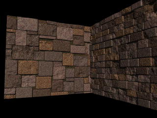

This is a macro that creates a stone or brick wall. It has two stone
placement methods, the first being the standard offset brick pattern, and
the second is a somewhat random placement pattern. As it is now, this thing
is easy to use, but renders really slowly. If anyone is interested, I will
be glad to post the source.
Dave
Download 'DBStones.jpg' (14 KB)
Preview of image 'DBStones.jpg'

I like best the second one (the one in the right). Darker, so more
useful for dungeons/castle/crypt or whatever, and the stones are
smaller. The other seems to be too strange... perhaps because of the
colors.
Azrael

By the way: how slow is 'slowly'? How long did it take you to render the
test image?

I think the test image took about 10 minutes on a 700MHz Athlon, but a
1024x768 screen-full of bricks took almost nine hours. The problem,
according to some folks who know a lot more about this stuff than I do, is
that the rays have to be tested for every brick in the whole scene.
Source posted on povray.binaries.scene-files.

I like it, I'll probably d/l the source when Peter or someone has fixed the
speed problem, (I've got too much on the go at the moment).

I had a little trouble posting the source, because I used a big height field
to take chunks out of the bricks to make them look more interesting, and I
forgot about the 1MB limit to postings. Anyway, the source is  now posted on
povray.binaries.scene-files, with instructions for re-creating the hf with
Fractint. Or, you can d/l the hf from
http://home.earthlink.net/~grasshoppah/DBStones.pot. (It's about 1.7MB.)
Dave

Well .. I like the 1st one pattern (the left one)
I'm working myself on a macro for building walls ...
currently I'm trying to use my wall-makro to build a tower ...
because of the rotation of a wall (of a tower) I only had an "simple!"
algorithm for the wall, producing similar results, like the right one of
yours ...
My question would be if it is possible, to use the first one in such I
manner I'm trying to do... Can I use it as the "Wall of a tower" ???
I think the rotation should be no problem here, but can I "connect" the left
and right side of the wall???
(hmm .. do you know what I mean ???)
But instead, can you describe the algorithm you use, to create the pattern
If I understand you right, you use a Heighfield for every Brick ??? This may
cause your speeding Problem ...
Try (for previewing) a normalmap such as crackle ... But I'm sure you know

Interesting question - a limitation of this macro (besides render time) is
that the stones of exterior walls that are perpendicular to each other won't
"match up."
For your purposes, going around the corner of a square building would be
similar to going around a circular tower, in terms of stone placement. The
algorithm that I used is pretty simple, and could be modified for a round
tower. Here's one possible solution:
1. Create a randomly sized new stone. Position it so that it's rotated about
the center of the tower to just past the edge of the very last stone that
was created and just barely above the HIGHEST old stone that's directly
beneath the new stone. Record the location and size of this new stone in
arrays. (An old stone would be directly under the new stone if they overlap
in the same x AND z space, assuming that you're building your tower up in
the y direction.)
2. Repeat step 1 until you reach a certain height. The rules outlined in
step 1 will cause the stones to automatically spiral upward. (There won't be
a need to "connect" the sides, there won't be any sides.)
3. For my macro, I actually made a second pass to fill in some gaps with
smaller stones, because there were many gaps after the first pass.)
4. Add some mortar, and you're done!
You're right, the height field slowed things up a bit, but that's not the
major speed factor. It has something to do with how POV stores objects
internally. The problem came when I "unioned" all the stones together. If
you don't need to cut windows into your tower or do any other CSG stuff then
you can avoid that problem.
