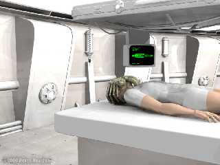

I think the scanner above the patient could do with some more work.
Comments, suggestions....
Peter H.
Download 'facehugger.jpg' (47 KB)
Preview of image 'facehugger.jpg'

"Peter Houston" <hou### [at] inamecom> wrote in message
news:3918082d@news.povray.org...
To me this person is reflective, clothes and all.  Wonder if anyone else
sees it that way too?
I really like the scene overall though.  Do you use the adaptive aa or just
more aa method 1?  Asking because of the jaggies in the diagonal lines.
About the screen device, I was thinking a couple red and yellow lights
wouldn't hurt.  Or whatever else which might make it more than just a screen.
I do.

For some reason, this is starting to look like a charcoal drawing. Maybe
you need jitter on your area lights?

In article <3918082d@news.povray.org>, "Peter Houston"
If that big gray thing is supposed to be a scanner, I highly doubt that
it would have pipes extruding out from it which pass _between_ it and
the patient.
In addition, if it's a scanner, then it probably deserves some funky
lights on it (if only to light up the patient from above, so the
physician can see clearly).
I'm also having trouble trying to visualise where the display is.  Is it
located 20cm above the patient's head, or is it back about a metre?
Regardless, it is in a location which would *always* get in the way.
Why not relocate it to that curved bulkhead-type-thing-with-the-dial?
One last thing, about lighting:  You've got a (uniformly and very)
bright medlab.  Have you considered dimming it down a bit, and making
the light sources visible?
Apart from that, I like it.  I especially like the dangling
pointy-thing.  Maybe I'm just sick.  ;^)
Henry.

It looks as if the skin of the "patient" is reflective, or has a thin plastic
layer.
Other than that: I love it!
I think so too.
I noticed this myself but I can't figure out what has happened, I added
reflection to all the surfaces in the room (it's all one texture) but not to
the figure, but for some reason it's gained the finish.  I'll have to
recheck the code, I'll try it without radiosity and see if it make a
difference.
just
You've lost me here, I am just using the default aa settings, 0.3 I think.
screen.
I'll add something to the screen.
Thanks,
Peter H.

Bill DeWitt  wrote >
Maybe
I tried adding jitter but it looked like the whole scene was sprayed with
black paint spots.
Peter H.
> the patient.
Well its not just a scanner, but a complete med station with all equipment
to hand, but I do agree about the pipes, I'll have to do something about it
I like the idea of it having a light source, I'll try it.  I was going to
add some display light s as well.
I'll take a look at it.
I tried to get similar lighting as appear in the film Alien, the med lab in
that is bright and the light source seems to be the entire ceiling.  If I
put lights on the scanner I may try lighting the whole scene with just
those.
> Henry.
Thanks,
Peter H.
