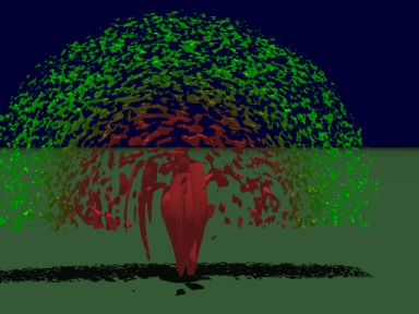

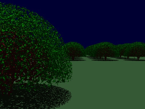

I've seen some tree makers here which are breathtaking in their visual
beauty.  I think that the coolest alorgithm for a tree, however, would
be procedural and not involve lots of translate & rotate statements.
Here's my first stab at a procedurally derived tree.  Further
experimentation underway.  Feel free to take this and improve it.
#declare rag=function{ 1/(x^2+y^2+z^2)^0.5*5}   // 35;

Looks OK for bushes or background trees. Keep up the work. Good luck. :)

    Not too shabby! Looks like an Orange Grove.
    I haven't tried to play with your code yet... looks like fun...

    Again, not too shabby. But I think that starting from this it will be
hard to improve it much. I would rather see something that is more like the
lparser system that can start from a basic trunk and then divides into
branches and twigs. Then you could use trace or something to put leaves on
it...
    I am really interested in this and am pounding away at it. But I have
little hope of accomplishing it. I can't get a division, not even a simple
Y... once I get that the rest should just be tedium.

From: Greg M  Johnson
Subject: Re: Towards a procedural tree macro (62kbbu)
Date: 26 Mar 2000 12:47:10
Message: <38de4d1e@news.povray.org>
I chose the noise3d function because it has its own 'branchability' built into
it.
See the following image, with a slightly higher threshold, and a cross section
through the branches.

Date: 26 Mar 2000 19:31:41
Message: <38DEAD4C.78E3@aol.com>
These trees would look just great in a background, I think; not as good
in the foreground, though.
Two small suggestions:
1) Turbulate the x, y, and z values just slightly based on their
distance from the center. This will give the trees a less hemispherical
look.
2) Change all n^2 to sqr(n) and n^0.5 to sqrt(n). As far as I can tell
from the function code, these should always be faster than using an
exponent.
I think I might give this a try in an old scene (where I wanted
background trees but settled for a textured height field) and see what
happens.
Lummox JR
