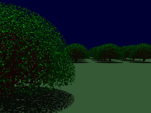

I've seen some tree makers here which are breathtaking in their visual
beauty.  I think that the coolest alorgithm for a tree, however, would
be procedural and not involve lots of translate & rotate statements.
Here's my first stab at a procedurally derived tree.  Further
experimentation underway.  Feel free to take this and improve it.
#declare rag=function{ 1/(x^2+y^2+z^2)^0.5*5}   // 35;
#macro Treegent(gent,tx,ty,tz)
//gent is currently useless randomizer,  translate to tx, ty, tz
union{
 isosurface{
         function{
noise3d((x+gent)/rag,(y+gent)/rag,(z+gent)/rag)&(-y-1) }
                accuracy .001
                threshold  .01
         contained_by {sphere{0,15} }
         bounded_by   {sphere{0,2 } }
 isosurface{
         function{  noise3d((x+gent)/rag,(y+gent)/20/rag,(z+gent)/rag)}
                accuracy .001
                threshold  .08
         contained_by { sphere{0,5} }
         bounded_by   { sphere{0,1} }
 pigment{
         spherical
  pigment_map{
                 [0      Green]
                        [.2     Brown]
                        [1     Brown]
                scale 12
        finish{ambient 0.1}
        translate <tx,ty,tz>
  #end
Download 'noiseforest2.jpg' (62 KB)
Preview of image 'noiseforest2.jpg'

Looks OK for bushes or background trees. Keep up the work. Good luck. :)

    Not too shabby! Looks like an Orange Grove.
    I haven't tried to play with your code yet... looks like fun...

Could you tell us what the value for gent you used in the posted scene?
All my attempts have given bad results, not at all like yours.
Thanks.

    Again, not too shabby. But I think that starting from this it will be
hard to improve it much. I would rather see something that is more like the
lparser system that can start from a basic trunk and then divides into
branches and twigs. Then you could use trace or something to put leaves on
it...
    I am really interested in this and am pounding away at it. But I have
little hope of accomplishing it. I can't get a division, not even a simple
Y... once I get that the rest should just be tedium.

ZERO.
I initially thought I could get it to given randomized appearance of each
tree, but then realized that I was too lazy to code it that way. Lemme know
if zero gives you trouble.......

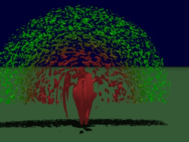

I chose the noise3d function because it has its own 'branchability' built into
it.
See the following image, with a slightly higher threshold, and a cross section
through the branches.

Two small suggestions:
1) Turbulate the x, y, and z values just slightly based on their
distance from the center. This will give the trees a less hemispherical
look.
2) Change all n^2 to sqr(n) and n^0.5 to sqrt(n). As far as I can tell
from the function code, these should always be faster than using an
exponent.
I think I might give this a try in an old scene (where I wanted
background trees but settled for a textured height field) and see what
happens.
