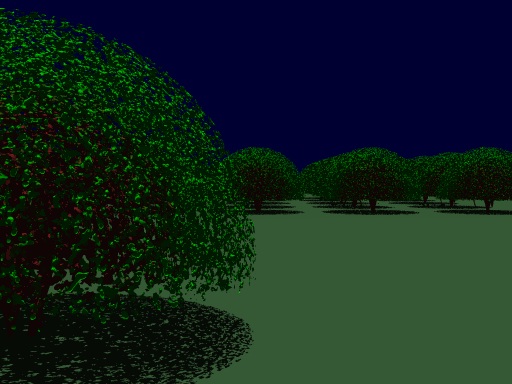

I've seen some tree makers here which are breathtaking in their visual
beauty.  I think that the coolest alorgithm for a tree, however, would
be procedural and not involve lots of translate & rotate statements.
Here's my first stab at a procedurally derived tree.  Further
experimentation underway.  Feel free to take this and improve it.
#declare rag=function{ 1/(x^2+y^2+z^2)^0.5*5}   // 35;
#macro Treegent(gent,tx,ty,tz)
//gent is currently useless randomizer,  translate to tx, ty, tz
union{
 isosurface{
         function{
noise3d((x+gent)/rag,(y+gent)/rag,(z+gent)/rag)&(-y-1) }
                accuracy .001
                threshold  .01
         contained_by {sphere{0,15} }
         bounded_by   {sphere{0,2 } }
 isosurface{
         function{  noise3d((x+gent)/rag,(y+gent)/20/rag,(z+gent)/rag)}
                accuracy .001
                threshold  .08
         contained_by { sphere{0,5} }
         bounded_by   { sphere{0,1} }
 pigment{
         spherical
  pigment_map{
                 [0      Green]
                        [.2     Brown]
                        [1     Brown]
                scale 12
        finish{ambient 0.1}
        translate <tx,ty,tz>
  #end
Download 'noiseforest2.jpg' (62 KB)
Preview of image 'noiseforest2.jpg'

From: TonyB
Subject: Re: Towards a procedural tree macro (62kbbu)
Date: 25 Mar 2000 23:30:20
Message: <38dd925c@news.povray.org>
Looks OK for bushes or background trees. Keep up the work. Good luck. :)
From: Bill DeWitt
Date: 25 Mar 2000 23:39:42
Message: <38dd948e$1@news.povray.org>
"Greg M. Johnson" <"gregj;-)56590\""@aol.c;-)om> wrote in message
news:38dd88f2@news.povray.org...
    Not too shabby! Looks like an Orange Grove.
    I haven't tried to play with your code yet... looks like fun...
From: mr art
Date: 25 Mar 2000 23:57:38
Message: <38DD98EB.B5596E93@gci.net>
Could you tell us what the value for gent you used in the posted scene?
All my attempts have given bad results, not at all like yours.
Thanks.

From: Bill DeWitt
Date: 26 Mar 2000 11:00:33
Message: <38de3421@news.povray.org>
    Again, not too shabby. But I think that starting from this it will be
hard to improve it much. I would rather see something that is more like the
lparser system that can start from a basic trunk and then divides into
branches and twigs. Then you could use trace or something to put leaves on
it...
    I am really interested in this and am pounding away at it. But I have
little hope of accomplishing it. I can't get a division, not even a simple
Y... once I get that the rest should just be tedium.
From: Greg M  Johnson
Date: 26 Mar 2000 12:32:39
Message: <38de49b7@news.povray.org>
ZERO.
I initially thought I could get it to given randomized appearance of each
tree, but then realized that I was too lazy to code it that way. Lemme know
if zero gives you trouble.......

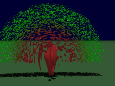

Date: 26 Mar 2000 12:47:10
Message: <38de4d1e@news.povray.org>
I chose the noise3d function because it has its own 'branchability' built into
it.
See the following image, with a slightly higher threshold, and a cross section
through the branches.
> it...
Download 'noiseforest02.jpg' (43 KB)
Preview of image 'noiseforest02.jpg'
From: SamuelT
Date: 26 Mar 2000 16:36:13
Message: <38DE858D.B0B3FCF5@aol.com>
I'm thinking a marriage between standard pov objects for branches, and
isosurfaces for leaves might be the best we can do to make good, and hopefully
fast-rendering trees. I might have to try it. :)

From: Lummox JR
Date: 26 Mar 2000 19:31:41
Message: <38DEAD4C.78E3@aol.com>
These trees would look just great in a background, I think; not as good
in the foreground, though.
Two small suggestions:
1) Turbulate the x, y, and z values just slightly based on their
distance from the center. This will give the trees a less hemispherical
look.
2) Change all n^2 to sqr(n) and n^0.5 to sqrt(n). As far as I can tell
from the function code, these should always be faster than using an
exponent.
I think I might give this a try in an old scene (where I wanted
background trees but settled for a textured height field) and see what
happens.
