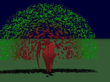

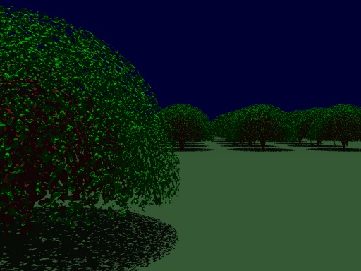

I've seen some tree makers here which are breathtaking in their visual
beauty.  I think that the coolest alorgithm for a tree, however, would
be procedural and not involve lots of translate & rotate statements.
Here's my first stab at a procedurally derived tree.  Further
experimentation underway.  Feel free to take this and improve it.
#declare rag=function{ 1/(x^2+y^2+z^2)^0.5*5}   // 35;

Download 'noiseforest2.jpg' (62 KB)
Preview of image 'noiseforest2.jpg'

From: mr art
Subject: Re: Towards a procedural tree macro (62kbbu)
Date: 25 Mar 2000 23:57:38
Message: <38DD98EB.B5596E93@gci.net>
Could you tell us what the value for gent you used in the posted scene?
All my attempts have given bad results, not at all like yours.
Thanks.

From: Greg M  Johnson
Date: 26 Mar 2000 12:32:39
Message: <38de49b7@news.povray.org>
ZERO.
I initially thought I could get it to given randomized appearance of each
tree, but then realized that I was too lazy to code it that way. Lemme know
if zero gives you trouble.......
Date: 26 Mar 2000 12:47:10
Message: <38de4d1e@news.povray.org>
I chose the noise3d function because it has its own 'branchability' built into
it.
See the following image, with a slightly higher threshold, and a cross section
through the branches.

From: Lummox JR
Date: 26 Mar 2000 19:31:41
Message: <38DEAD4C.78E3@aol.com>
These trees would look just great in a background, I think; not as good
in the foreground, though.
Two small suggestions:
1) Turbulate the x, y, and z values just slightly based on their
distance from the center. This will give the trees a less hemispherical
look.
2) Change all n^2 to sqr(n) and n^0.5 to sqrt(n). As far as I can tell
from the function code, these should always be faster than using an
exponent.
