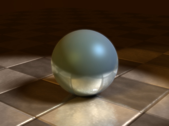

The classic got new clothes.
  I thought that since we have got lots of new cool features, why not try
them on the classic image? The image uses the following features:
  - Blinn highlights
  - Variable reflection
  - Blurred reflection
  - Photon mapping (unfortunately almost invisible)
  - Radiosity (gives the overall orange tint to the image)
  - Soft-glow
    Total Time:    2 hours 43 minutes  12.0 seconds (9792 seconds)
  Perhaps it could be used as example scene in pov 3.5?
Download 'Sphere.jpg' (61 KB)
Preview of image 'Sphere.jpg'

Nieminen Juha <war### [at] sarakerttunencstutfi> wrote in message
news:38be3132@news.povray.org...
Very nice - I've often thought that "Reflecting Spheres on Chequered
Background" would make an amusing and enlightening IRTC subject.

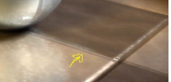

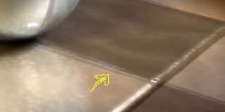

What's with the strange shadow lines ?
*see attached image for reference.
Download 'shadow.jpg' (16 KB)
Preview of image 'shadow.jpg'
From: Nieminen Juha
Subject: Re: My version of the reflecting sphere on checkered plane
Date: 2 Mar 2000 05:29:21
Message: <38be4281@news.povray.org>
Ken <tyl### [at] pacbellnet> wrote:
: What's with the strange shadow lines ?
  Yes, it looks like the half of the gap that is closer to the camera (ie. the
normal points away from the camera) should be brighter than the other one
(normal pointing towards the camera), but they look equal in brightness.
  The main light source is rotated just 20 degrees from the z-axis so it's
not that much facing the above mentioned gap half. Perhaps that is the
reason. Or perhaps there's still some strange normal bug?
  Or perhaps you are talking about the white lines in the gap? I'm not
completely sure where does them come. Perhaps they are reflections from
the sphere and/or highlights. Or perhaps another normal bug?
  I can post the source code if someone wants to investigate.
main(i,_){for(_?--i,main(i+2,"FhhQHFIJD|FQTITFN]zRFHhhTBFHhhTBFysdB"[i]
):5;i&&_>1;printf("%s",_-70?_&1?"[]":" ":(_=0,"\n")),_/=2);} /*- Warp -*/
I was thinking it might be a side effect of using the variable and/or
blurred reflection parameters.
I do know that if I rendered this as one of the example scenes that
come with the program I might be tempted to ask if it is a bug.
I struggle with this phenomena a lot.
Tried making a picture of a photo floating in a white whashing-tray. The
caustics of the water are almost invisible.
When I do this in the real world in my darkroom, the caustics are very
visible. It seems the eye can adjust for brightness levels. Pov-Ray can
not.
Nathan: Is it possible to make the photon intensity variable so they are
not only visible in shaded areas but also in bright surroundings?
Ingo
