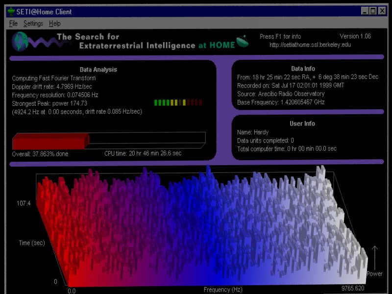

Here is a picture made several months ago. I had not found a function for a
background-image, so the image and the fake-stuff had to be put before the
camera. The fake-stuff is a function in pov-ray (some fourier-functions).
The reason to fake this was to put something like a "alien-head" to the
data-line, but someone with photo-shop was faster ...
Hartmut
http://www.killozap.de
Download 'Seti.jpg' (105 KB)
Preview of image 'Seti.jpg'
> Hartmut
