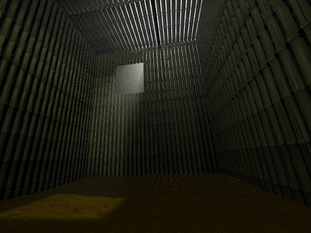

This is a scene I'm working on to get used to global media and more
difficult lighting conditions. I also just learned you can make almost any
POV texture value negative, and I got some freaky results at first. In this
scene, the ambient value of the bamboo poles is a subtle -0.08. The
scattering will probably be changed back to type 1, the light rays seem more
visible.
 Any opinions are very welcome,
Ryan

Making an object'c color (or ambient) negative is a good way to show
it through thick emitting and/or scattering media.
Use a scattering type 2 or 3. To make it more visible, lower
extinction. The docs say it's unrealistic but I don't think so;
fine-tuning the extinctino value can work very well for realism and it
should not necessarily be limited to the [0..1] range (though in this
case the lower the better).
The bamboo poles are too identical. Maybe randomize them a bit in
terms of thickness and segment length/position.
Peter Popov

The large illuminated area outside seems disproportionate for the slight
visibility of the air inside.
From: Ryan Twitchell
Subject: Re: Bamboo Hut (~64k)
Date: 1 Mar 2000 15:31:40
Message: <38bd7e2c@news.povray.org>
Yes, I just changed from global media to a box with media representing the
inside of the hut. This is more like it would be in reality, and now my sky
shows up too...
 Ryan
