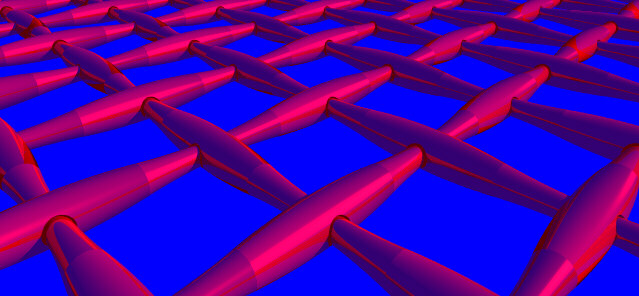

I have made the "fence" in the image below
from two different shapes, both made with
a torus.
But there seems to be a problem with the
light reflections from the texture,
(which is common to the two shapes;
Soft_Silver with a Red pigment):
The reflection normal of the surfaces
appears to make a sudden change of
direction in the region where the two
shapes meet.
(There is only one light source.)
Is this correct behaviour?
(I'm using standard POV-Ray v3.1g for
Windows.)
And also: Does anyone know of any other
basic shapes in POV-Ray, or a quartic
equations, that can be used to make a
"cigar" shape (like the "convex cylinder")
in my image ?
Tor Olav
mailto:tor### [at] hotmailcom
Download 'invtorus07.jpg' (69 KB)
Preview of image 'invtorus07.jpg'

Apparently you have the end parts of each tube piece made with the inside
donut hole of the torus.  Try 'inverse' in those.  What texture is used exactly?
Is there a 'normal' statement involved or is it just a 'finish'?

I think the texture difference; while perhaps unintended, looks very cool :>
Yes the 'end'-part is done that way: The concave
shape is a difference between a sphere and a torus.
I have now tried to replace the difference with an
intersection of a sphere and a torus with the
'inverse' keyword. (Is this what you meant?)
==> Same result. No change in the reflections. :(
  texture { Soft_Silver }
  pigment { color Red }
No. Just the above two statements.
Heh! :)
I was so focused on the problem that I did not see that!
Thank you.

Nope.  I was talking about the torus surface itself, maybe if it's inversed then
perhaps the reflection will right itself by then being on the "outside".
Realize though that by turning the torus inside-out then the CSG will
change too.  I think that a inverse used in the intersection or difference
should cancel that change.
Rather than try and make guesses I just tried to make such a thing myself
and I couldn't even see any reversed (or whatever) reflection:
First: Thank you very much for trying to help me!
I'm quite frustrated, because I need the reflections from this
middle "cigar" shape to behave correctly(?) in other scenes.
I have now included some of my source code below so that you can see
what I'm actually doing.
Note that my convex "cigar" shape is made with a torus that has a
greater minor radius than major radius.
And I now wonder if this could cause the odd change in reflections?
(As I understand from your code, you are making a similar shape by
scaling a sphere along an axis.)
Regards
Tor Olav

I checked out what you had there and also didn't see any way of getting the inside to
become outside, which is the case for that torus with the larger minor radius than
major.
Not that it was going to be possible using inverse or variations thereof (I even gave
scale -1 a try), but as it turns out I couldn't even get the MegaPov
'interior_texture' to
put it right.
This means to me that something goes wrong with that torus.  Not a complete surprise
either since it's been said before by other people how that particular shape isn't
reliable.
The problem is in the inner part of the torus, even though usually an outer surface,
ends
up inside itself.  So the raytracer must be confusing it entirely.
> reliable.
ends
So it is the "ciagar" shape that messes up the
reflections.
That's a pity. =(
Is this to be considered as a bug ?
And if so, do you know if the other people you
mentioned have posted a bug report on the subject?
I have also noticed that this shape is hollow.
And therefore it doesn't behave in CSG operations.
Tor Olav

I don't know if it's a mathematic problem with the torus and if not then it must be
related to the raytracer.
Maybe there's a possible fix but I'm not one who could even begin to guess the answer.
I think it might have been said to be a "bug", but again I couldn't say.  Straining to
remember
I think people were conceding it to be a problem with the raytraced surface and might
not
be
easily fixed.  Takes those math geniuses out there (and here) I'm sure.
"Tor Olav Kristensen" <tor### [at] hotmailcom> wrote in message
news:3904F7A6.AF260EC3@hotmail.com...
surprise
| > reliable.
surface,
ends
| reflections.
| That's a pity. =(
| Tor Olav
| http://www.crosswinds.net/~tok/tokrays.html
