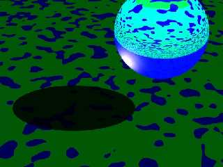

Could someone help me tweak this code to get real caustics?
#include "colors.inc"
#version unofficial MegaPov 0.4;
  global_settings {    assumed_gamma 2.2
    //hf_gray_16
global_settings{
  photons{
        count 200000000  // count 20000
    //autostop .01
    jitter .4
//    spacing 1
  camera {
   location <0,10,-26>      look_at <-3,-3,-2>
    angle 30
background{Blue}
 light_source { <200, 200, 10> color White*0.75}
#declare ck=6;
light_source {
    <0, 0.02, 0>
    color White*2
   photons {
    global
    refraction on
    reflection on
isosurface{
        function{
        "sphere",<3>
        accuracy 0.001
         threshold 0.10
          contained_by
                      sphere{0,3.5}
           clipped_by
                        sphere{0,3.4}
        interior{
        ior 1.5
        pigment{rgbft <1,.9,.9,1,1>}
        finish{ambient 0.2 reflection 0.15
        blinn 1 facets .2 }
          photons {
    target
    refraction on
    reflection on
    ignore_photons
      rotate <0,0,0>
        hollow
plane{y,-6
        //normal {bumps scale 0.01}
        pigment{
        function {noise3d(x,y,z)}
                  color_map {
                                [ 0.0 color  rgb <0,0,1>]
                                [0.68 color rgb <0,0,1> ]
                                [ 0.72 color rgb <0,1,.1>]
                                [ 0.28 color rgb <0,1,.1>]
Download 'nocaust.jpg' (50 KB)
Preview of image 'nocaust.jpg'

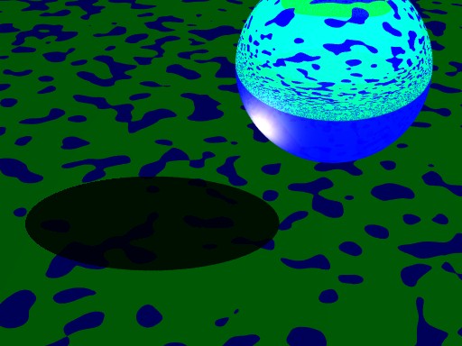

1) get rid of
    photons {
      global
      refraction on
      reflection on
in the second light source and change the light source's brightness to White
instead of White*2.
2) change the pigment of the isosurface sphere from
to
        pigment{rgbf <1,.9,.9,1>}
3) use this for your photon count:
    count 5000
-Nathan

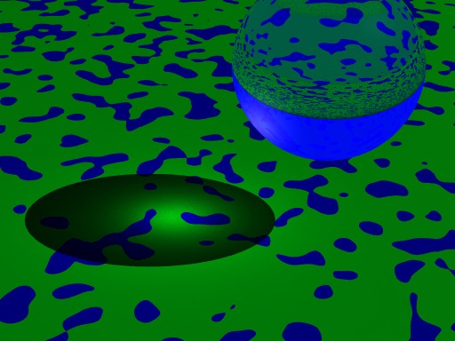

From: TonyB
Subject: Re: No caustics (50kbbu)
Date: 2 Mar 2000 20:06:33
Message: <38bf1019@news.povray.org>
I solved it by lowering the light intensity and eliminating the finish from
the sphere.

From: Greg M  Johnson
Date: 2 Mar 2000 22:43:42
Message: <38bf34ee@news.povray.org>
Wicked!
(Steve's advice, however, of removing
ignore_photons
,  is not correct, right?)
Also, why filter and not transmit?
Nathan Kopp wrote:
> 1) get rid of
>     photons {
>       global
>       refraction on
>       reflection on
> instead of White*2.
> to
>     count 5000
> -Nathan

From: Jerome
Date: 3 Mar 2000 11:12:34
Message: <38BFE46C.DA8095E0@iname.com>
Greg M. Johnson wrote:
> Wicked!
> ignore_photons
	Right, ignore_photons simply means that you don't want any
caustics on the sphere itself, *not* that photons don't get
shot at it (that's controlled by the reflection and
refraction keywords...)
		Jerome
From: Nathan Kopp
Date: 4 Mar 2000 10:37:53
Message: <38c12dd1@news.povray.org>
Greg M. Johnson <"gregj;-)56590"@aol.c;-)om> wrote...
Filter changes the color of the light that passes through the object,
transmit does not.  If you use both, they add together, which doubles the
intensity of the light.
Actually, for the best realism, you should use transmit combined with
distance-based attenuation using fade_color, fade_distance, and fade_power.
-Nathan
