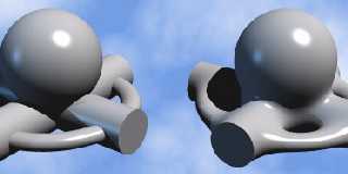

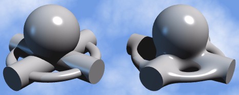

Hello everybody. I was a bit concerned about how I told everyone a
future isosurface tutorial would show them how to blob functions
together (spheres, cylinders, torii - you name it). I could actually do
it back then, but learned that the method had very inconsistant results.
I was starting to think I might never actually be able to blob stuff
together very good at all. That is, until the other day, when I was
trying some new functions.
Attached is a before and after image of an isosurface. The first
isosurface has 2 cylinders, 1 sphere and 1 torus all merged together.
You can do this with normal pov. The second shows how well my new
blobbing method works. There seems to be very little size-reduction in
the original components, making this method very easy to control. You
can be assured this technique will be making it into a tutorial :)
Any thoughts? Critiques?
Samuel Benge
E-Mail: STB### [at] aolcom
Website under construction.
Download 'blobbed.jpg' (18 KB)
Preview of image 'blobbed.jpg'

When you recommended the thing back then, and it let to my torusblob and
boxblob images, you said to multiply the formulas for one object and the
other, and this worked great. What changes or new discoveries did you make?

The function now looks like this:
#declare Thr=.000000001;
function
  (1+Thr)
  -Thr^(x^2+y^2+.95) //cylinder
  -Thr^(y^2+z^2+.95) //cylinder
  -Thr^( sqr(x^2+z^2-.6)+.975+sqr(y*2) ) //toru
  -Thr^(x^2+sqr(y-.5)+z^2+.75) //sphere
 threshold 1 sign 1

Yea. I look forward to the tutorial. In the meantime, could we see the code
for this scene so we can play with it? :{)

I tried to "free view" it and my eyes pleaded with me to stop.
I think it'll make for some great coated objects such as paint or rubber
coatings.
If I get what you are saying about no size reduction of the original converted
to iso'd objects then it definitely is good for things with coatings on them.
