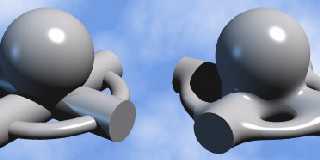

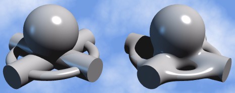

Attached is a before and after image of an isosurface. The first
isosurface has 2 cylinders, 1 sphere and 1 torus all merged together.
You can do this with normal pov. The second shows how well my new
blobbing method works. There seems to be very little size-reduction in
the original components, making this method very easy to control. You
can be assured this technique will be making it into a tutorial :)
Any thoughts? Critiques?

The function now looks like this:
#declare Thr=.000000001;
function
  (1+Thr)
  -Thr^(x^2+y^2+.95) //cylinder
  -Thr^(y^2+z^2+.95) //cylinder
  -Thr^( sqr(x^2+z^2-.6)+.975+sqr(y*2) ) //toru
  -Thr^(x^2+sqr(y-.5)+z^2+.75) //sphere
 threshold 1 sign 1

Yea. I look forward to the tutorial. In the meantime, could we see the code
for this scene so we can play with it? :{)

This is great progress! (I am among the many that have visited your tutorial
off and on and have been disappointed by the fact that after so many months it

I tried to "free view" it and my eyes pleaded with me to stop.
I think it'll make for some great coated objects such as paint or rubber
coatings.
If I get what you are saying about no size reduction of the original converted
to iso'd objects then it definitely is good for things with coatings on them.
