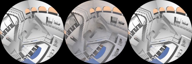

By partly radiositied I mean only one side of the stereopair used it, the other
is lit with a bright light and has more than default ambient as well.  Both were
darkened somewhat by raising the 'assumed_gamma'.
Oh, and this is a combination crossed and parallel image too so all should be
happy.
The Relativity model (Escher stairs I like to call it) was done by someone else
in Dxf format and I converted it over to Inc with 3DWinOGL (by Thomas Baier).  I
almost never got the thing positioned right, bet you can guess why.  To explain
what I was thinking of by doing the non-radiosity + radiosity renders it occured
to me how well suited stereopairs could be for merging images to cause varied
effects.  The light and dark changes from one to the other make for an
interesting perception.  I've always kind of liked that.  Perhaps a good way to
describe the possibilities is to think of a window thats both lit and unlit or a
object which exists in only one image yet shows up in the resulting 3D picture
seemingly detached somehow.
// omniVERSE
// http://users.aol.com/inversez/

From: Mike
Subject: Re: 3D Escher Relativity partly radios'd ~52KB
Date: 15 Jan 2000 10:56:50
Message: <3880961F.284BFEEA@aol.com>
Now this one really stands out.  Why three images?  I only got two eyes. :)
-Mike
From: 3Dude
Date: 15 Jan 2000 14:27:20
Message: <3880ca18@news.povray.org>
Excellent! The use of radiosity for one eye view and not the
other introduces retinal rivalry, which some think should be
avoided, but I don't, I think it adds a glowing effect.
Harold
Date: 15 Jan 2000 23:03:14
Message: <3881407D.DA28E77D@faricy.net>
He said it's both a cross-eye and a parallel. The left two are viewed one way
and the right two the other.
Date: 15 Jan 2000 23:46:42
Message: <38814AB2.EDD4AF7B@faricy.net>
I went and had a look at the actual piece, the windows are different but the stairs
have the exact same layout.
From: omniVERSE
Date: 16 Jan 2000 02:07:40
Message: <38816e3c@news.povray.org>
Yep, I don't think this model is an exact replica of the Relativity drawing.  I
checked this with the picture I have of it in a book and tried to align it
correctly before realizing I needed to mirror one axis by using 'scale
<-1,1,1>'.  Then I noticed the archway windows were continuing where they end in
the drawing (only supposed to be two in upper left corner).  It was no easy task
to arrange the camera into position anyway, believe me.
Not positive but I think I got the 3ds file at:
http://www.3dcafe.com/asp/architex.asp
called escher.zip
news:38814AB2.EDD4AF7B@faricy.net...
stairs
From: Sander
Date: 16 Jan 2000 16:50:50
Message: <38823d3a@news.povray.org>
I tried to see depth in these Escher pictures, but I can't. Not considering
the changes (radiosity) to the middle one: are they something you rendered
with POV? There doesn't seem to be visible the typical POV plasticity about
them. When I look at two different pictures in detail using PS5, I don't see
very much difference in position between the objects that should be in front
and others that should be in the back, as you can observe in clearly 3D
picture sets. I try to understand what is going on here, but I don't...
Help!
Sander
Date: 16 Jan 2000 18:14:52
Message: <38824E5F.F2411A0D@faricy.net>
I might make a POV gallery with this type of layout, if I ever get around to it.
From: omniVERSE
Date: 17 Jan 2000 03:19:20
Message: <3882d088@news.povray.org>
Yes, I think the shift isn't too great.  The camera being a 'fisheye' with
'angle 160' doesn't help.  Although the shift in position is about the typical
ratio of 1 unit sideways to 30 units object distance mentioned before I also
didn't want it to be too much.  So it should look about like a very large open
area, which it is I guess, not a smaller room-sized area.
Admittedly I saw very little depth in it which is why I shifted the camera even
further than a first trial at it.  Think you could be right and it lacks enough
3D depth nonetheless, the I've always used a 'perspective' camera with something
like 'angle 22.5' (odd number, I know) for them.

From: omniVERSE
Date: 17 Jan 2000 03:22:56
Message: <3882d160@news.povray.org>
I should have also stated before that the crossed pair is left/center and the
diverged pair right/center.  Just realized I never even said that.  I lose
points that way, I know, sorry  ;-)
