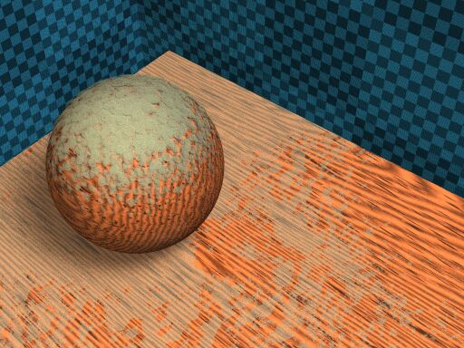

This is my attempt at dust with pov.
The dust on the desk is a height-field.  The image
for the HF was created by pouring some flour on my
scanner's glass, to get credible distribution of
dusty areas (note for later : remove flour from scanner).
The dust on the sphere is generated by using the
MegaPov "trace" function, and placing discs at intersection
points.
Not very satisfied of the result.  Tried to use a
colormapped texture on the sphere's dust, but it looked
ugly.
Maybe I will try to put other objects and trace some flour..
.err.. dust on these.
Fabien.

All the dust here (yep, no feather duster) has more of the 'crand' sort of
look to it.  This has the good distribution of it I suppose but appears as a
coating of something other than dust, especially the ball since it has so
much opacity.
All in all a nice attempt at it anyhow.  Hate to think you had flour on a
scanner though.
Looks more like dred mud (sphere) and dried water (you know, like the stains
on the shower doors).

It's too blobbish. It looks more like they're coated with wet flour...

That's rather thick dust...if it were taller it would make good snow that's
already melting
