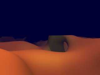

I've made a smooth landscape using an isosurface containing noise3d + y
.  Note in the image below how some of the features are truncated: flat
tops. I want it to be completely smooth, but have this general feel.   I
was trying to figure out what might have been wrong with my code.  But
then I remembered a similar thread about some of the noise-based
pigments in povray.  Did I hear something to the effect that the pov
designers used an unorthodox definition of the noise (something about
the interval?) ?
The question is: which of the scenarios below are most probable:
1. I may acheive smoothness by fixing my code;
2. I will fail because these flat tops are inherent in any (correct)
application of noise;
3. I will fail until a pov version comes out with a "correct"
application of noise.

From: Ron Parker
Subject: Re: Ignorant question re: noise (5kbbu)
Date: 7 Jan 2000 08:39:17
Message: <3875ec85@news.povray.org>
My guess is 1.  I don't think noise3d suffers from the same problems
as bozo and other patterns.  Try making your bounding box larger.

From: Greg M  Johnson
Date: 7 Jan 2000 08:46:20
Message: <3875ED65.89CDEDB5@my-dejanews.com>
Thanks for the speedy reply.
No, I believe I have a bounding SPHERE, but I'll have to check the code
at home this evening.
I acheived this surface by something on the order of:
    isosurface{noise3d(x,y,z)  + y }.

From: Chris Huff
Date: 7 Jan 2000 08:55:28
Message: <chrishuff_99-025418.08553807012000@news.povray.org>
Actually, it does, but it doesn't show up in most images because the
flat area is in the center of the blobs formed. This simple isosurface
demonstrates the problem:
isosurface {
   function {y - noise3d(x*2, 0, z*2)*0.33}
   eval
   max_gradient 1.1
   threshold 0
   bounded_by {box {<-2,-2,-2>, < 2, 2, 2>}}
   accuracy 0.001
   texture {
      pigment {color rgb < 0.095, 0.45, 0.2>}
Chris Huff
e-mail: chr### [at] yahoocom
From: Mike Wilson
Date: 7 Jan 2000 09:42:17
Message: <3875FB3E.46031B75@iastate.edu>
I may be compeletely wrong, because I don't have a lot of experience
with isosurfaces, but I did run into something similar.  It seems to me
that the isosurface code works "backwards" from normal POV-Ray
nomenclature. i.e. something like isosurface{y-noise3d(x,y,z)} actually
adds the height of the noise to the plane whereas
isosurface{y+noise3d(x,y,z)} subtracts the noise from the surface.
Likewise it seems that increasing the x,y,and z values makes for smaller
noise features. e.g. noise3d(x*20,y*20,z*20) makes finer detail than
noise3d(x*3,y*3,z*3).
You may simply be running into your bounding box.  Try translating the y
component of your isosurface down a bit at see it the tops of your noise
"finish out".
Mike Wilson

From: Chris Huff
Date: 7 Jan 2000 10:04:49
Message: <chrishuff_99-077D84.10045907012000@news.povray.org>
That isn't backwards at all. The isosurface of the function y-1 will
consist of all points where y-1 is the threshold value. Increasing the
amount subtracted from the y coordinate means y has to be higher to
result in the same value. When noise3d equals 1, y has to equal 1. When
it is added instead, y has to equal -1 to get the same result.
Again, this is not backwards. If you multiply x by 2, than the result of
that expression(2*x) will be a certain value at half the distance it
would be without the multiplication. The result is compressing the
coordinates into a smaller space, scaling down.
If x is 3, 2*x will be 6, and the features that would have been at x=6
will be at x=3 when 2*x is used.
Chris Huff

From: Mike Wilson
Date: 7 Jan 2000 10:30:17
Message: <3876067B.A9E916EE@iastate.edu>
You're right. of course.  I wasn't implying that it was wrong, just that
it "appears" backwards compared to other types of scaling.  For example,
if I wanted a large bump scale on a normal, I would increase it, but
with noise3d, I would use a smaller number.
As, I mentioned, I don't have a lot of experience with isosurfaces, so I
don't think in terms of how the function will be satisfied; I'm relating
it to similar POV-Ray statements.
Mike Wilson

From: omniVERSE
Date: 7 Jan 2000 15:34:23
Message: <38764dcf@news.povray.org>
Whoa, did I not catch on to this reasoning at all!
If x=3 it will be x=3 when 2*x??
Okay, I'm lost.  Unless it's a average of the noise function....
From: Chris Huff
Date: 7 Jan 2000 16:05:43
Message: <chrishuff_99-D08175.16055207012000@news.povray.org>
In article <38764dcf@news.povray.org>, "omniVERSE" <inv### [at] aolcom>
No, if the function returns a certain value at 6 units along the x
axis(x=6), than if it is given 2*x instead of x, it will think x=6 when
it is really x=3. So the value that showed up at 6 units now shows up at
3 units.
N=What the function "sees"
V=The real value
With N=V:
