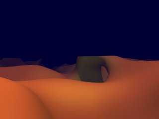

I've made a smooth landscape using an isosurface containing noise3d + y
.  Note in the image below how some of the features are truncated: flat
tops. I want it to be completely smooth, but have this general feel.   I
was trying to figure out what might have been wrong with my code.  But
then I remembered a similar thread about some of the noise-based
pigments in povray.  Did I hear something to the effect that the pov
designers used an unorthodox definition of the noise (something about
the interval?) ?
The question is: which of the scenarios below are most probable:
1. I may acheive smoothness by fixing my code;
2. I will fail because these flat tops are inherent in any (correct)
application of noise;
3. I will fail until a pov version comes out with a "correct"
application of noise.

From: Ron Parker
Subject: Re: Ignorant question re: noise (5kbbu)
Date: 7 Jan 2000 08:39:17
Message: <3875ec85@news.povray.org>
My guess is 1.  I don't think noise3d suffers from the same problems
as bozo and other patterns.  Try making your bounding box larger.
These are my opinions.  I do NOT speak for the POV-Team.
The superpatch: http://www2.fwi.com/~parkerr/superpatch/
My other stuff: http://www2.fwi.com/~parkerr/traces.html
From: Greg M  Johnson
Date: 7 Jan 2000 08:46:20
Message: <3875ED65.89CDEDB5@my-dejanews.com>
Thanks for the speedy reply.
No, I believe I have a bounding SPHERE, but I'll have to check the code
at home this evening.
I acheived this surface by something on the order of:
    isosurface{noise3d(x,y,z)  + y }.

From: Chris Huff
Date: 7 Jan 2000 08:55:28
Message: <chrishuff_99-025418.08553807012000@news.povray.org>
Actually, it does, but it doesn't show up in most images because the
flat area is in the center of the blobs formed. This simple isosurface
demonstrates the problem:
isosurface {
   function {y - noise3d(x*2, 0, z*2)*0.33}
   eval
   max_gradient 1.1
   threshold 0
   bounded_by {box {<-2,-2,-2>, < 2, 2, 2>}}
   accuracy 0.001
   texture {
      pigment {color rgb < 0.095, 0.45, 0.2>}
Chris Huff
e-mail: chr### [at] yahoocom
