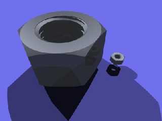

Hi there!
I sat down the last evenings and wrote my first macro. Nothing
incredible, just a little tool to create realistic nuts (see small
example at the bottom).
You find the macro and a small tutorial how to use it at:
http://www.ica.uni-stuttgart.de/~marc/nuts.html
Any comments are welcome!
Marc
Marc Schimmler
Download 'nut1.jpg' (8 KB)
Preview of image 'nut1.jpg'

Thanks David! The book about construction of machines I've got are in
german only. Pitch is actually the term I was looking for. I will change
the term slope to pitch in the documentation and maybe in the macro as
well!
Marc
