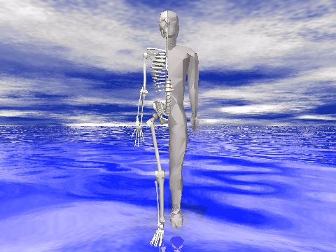

A proof of concept/technique image. Not bad considering the poor
quality of the solid half I used for the test.
Ken Tyler
mailto://tylereng@pacbell.net
Download 'newskel.jpg' (39 KB)
Preview of image 'newskel.jpg'

The proportions of the halves are noticeably different. Correcting that may
prove difficult unless you find matching models or possess Poser (or some
such) to tweak them in. But maybe if you scale the solid half a bit taller
it might match close enough.
I'm eagerly awaiting to see what will evolve from this.
Margus

He's walking Margus. Proportions are right I guess, what would be wrong
is the arm/leg positions. Normally asymmetrical(?) while walking,
running.
Actually you may be right though, the reflective ground seems to give
away the fact that the solid side foot is higher then the other and not
behind. Maybe...

It might be a scaling problem, and it might be an anatomical problem. :)
If you had your skin and muscles removed, wouldn't you slump? :)
what technique is it that you're proving?

I like this one.. The concept is definitely worth more work... Considering the
mesh you have now, would it work to add some furr using Chris Colefax's macro? I
think it may cover some of the rougher edges, and make it look more
"neanderthalic" or something...

Lewis wrote:
  How to halve a pre-made mesh object obtained from the net. It looks
easier that it really is. A lot of it depends on the tools you have to
work with and the order in which the mesh was created. Another aspect
is sizing of of two mesh objects from different sources. As it has been
pointed out on the thread the proportions are different between the two
objects. I need so somehow stretch the leg on the solid mesh while
leaving the body scaled as is. This means a simple linear scaling won't
work in this case.
  Another reason for trying this is I simply thought it would make for a
cool looking image ;^ )
Ken Tyler

I'd be too tempted to load it into TruSpace and deform one or both meshes.
My hat's off to you if you work it out without sectioning.
GrimDude
