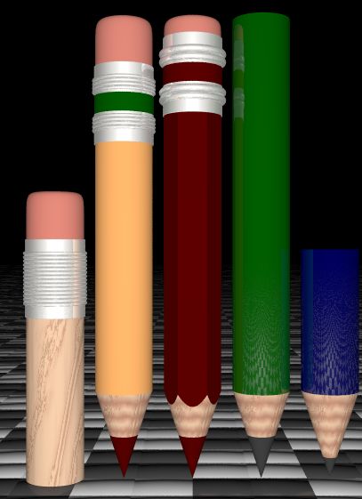

Ok - there are a number of pencil models available - but none that did JUST
what I wanted. So I whomped up this one.
_everything_ is controlled by a parameter, and the size is strictly
controllable, known, and it even gives you the bounding cylinder for the
pencil. You should be able to place the models this macro creates precisely
in a scene.
Attached are a few examples, all pencils are created  by the same macro,
just with different parameters.
Any suggestions at how to improve these models is much appreciated.
NOTE : this combines the ideas of several models as well as a few original
ideas, and some staring are real pencils. I could not have done this, had
other people not written, and published their models. Thank you.
Parameters to date
The pencil has it's sharpened point at <0,0,0>, extends in the +y direction,
and is completely bound by cylinder
 <0,0,0>,<0,pencil_length,0>,pencil_radius }
FLAGS
Round : If yes, make the pencil round, else, make a hexagonal body.
Sharpened : If yes, trim the pencil body and lead with the shear_cone to
make a pointed pencil. Otherwise, the pencil will be 'brand-new'
Eraser : If yes, shorten the pencil body, add an eraser, and add an eraser
sleeve. The total length of the pencil still equals pencil_length.
Painted : If yes, slap a coat of paint on the pencil (see Matched flag), if
not, leave it bare wood_texture.
Matched : If yes, make the pencil's paint the same color as it's lead. If
not, make the paint paint_texture.
VARIABLES
pencil_radius : The outside radius of the pencil. if the round flag is set,
this will be the radius of the cylinder, if not, the hexagonal prism that
makes up the body of the pencil will be inside this cylinder, making the
midpoints of the sides _less_ distant from the center.
pencil_length : this is the total length of the pencil, including eraser, if
included.
lead_radius : the radius of the cylindrical lead inside the pencil body.
cone_taper : this is the measure of the angle (in radians) of the 'sharp
point' of the pencil. Lower values will make the cone narrower, and make the
sharpened part longer.
Eraser_length : The length of the rubber eraser on the end of the pencil.
Partially hidden by the metal sleeve.
wood_overlap : the amount the metal sleeve fits over the wooden shaft of the
pencil
eraser_overlap : the amount the metal sleeve fits over the eraser.
spacing : the gap between the ends of the eraser sleeve, and the beginning
of the ridged sections. Note : the way that the ridges are constructed
sometimes means the gap on the eraser side is less. This only occurs if the
ridged region is not of a length that is a multiple of 2*ridge_radius.
ridge_radius : the radius of the individual torus ridges on the metal eraser
sleeve.
band_width : the width of the painted band in the middle of the eraser
sleeve. Can be set to zero if no such band is desired.
metal_thickness : the thickness of the eraser sleeve.
Textures
paint_texture : the texture used for the coat of paint, if the pencil is
painted, and if the matched flag is not set.
lead_texture : the texture used for the pencil lead, and the paint_texture
IF the matched flag is set.
Wood_texture : the texture of the wood body of the pencil. NOTE : this is
the texture of the sharpened surfaces, and the trimmed ends only. If the
pencil is trimmed by CSG, the body of the pencil will show the
paint_texture.
eraser_texture : the texture of the eraser, if present.
holder_texture : the texture of the eraser_sleeve, if present
band_texture : the texture of the painted band on the eraser sleeve, if
present.
I would like to add the ability to put writing on the side of the pencils
before I post the actual macro, provided there is interest.
Suggestions anyone?
Download 'macrotest.jpg' (31 KB)
Preview of image 'macrotest.jpg'

Hay now that's great, especially all the customization flags and variables! One
suggestion though. The wood to the end of the pencil, the sharpened end, should
not be banded like that, instead rotate the wood texture so the band runs up and
down along the y axis, also scale it down a bit. And another thing is the
pencils in this picture are too fat. I know that with the macro its just a
matter of changing some variables, but you asked for comments on how to improve
them. Other than this you've done a great job!
Charles Krause wrote:

Thomas Lake wrote in message <372555A5.56C8FB8B@home.com>...
One
should
up and
Yep - this is just a case of defining the wood texture properly.
The scale here is 1 Pov = 1 inch, and to fit in the picture, these are all
2-4 inches long. So these are stubby pencils :) I'm aware they're not the
proper length.
improve
Thanks :)

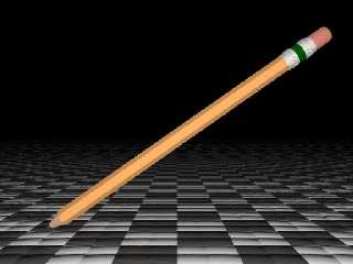

Here you go, a more realistically scaled pencil.
It is 7" long, 1/3 inch in diameter, the lead is 1/8 inch in diameter, the
erase 1/3 inch long (doesn't look like the user makes a lot of mistakes
:) ). I didn't fix the wood grain though.
Download 'macrotest.jpg' (25 KB)

the erasers - you know, where the eraser is worn away and has sublte graphite
smears. My second suggestion may be a bit nit-picky but not meant to be: Where
the lead and wood meet is never so cleanly clipped - at least never has it been
for the some-odd-millions of pencil I've chewed through in life. My third
suggestion: The ability to vary the sharpness/dullness of the lead tip. Based on
the resulting image, your macro seems a very nice (and useful) piece of work, I
can't wait to try it out when you're ready to share.    ;-]
KB-
> in a scene.
> Parameters to date
> FLAGS
> VARIABLES
> included.
> pencil
> sleeve.
> Textures
> paint_texture.
> present.
> Suggestions anyone?
From: Charles Krause
Subject: Re: Pencil Macro Critique?
Date: 27 Apr 1999 04:23:52
Message: <37256608.0@news.povray.org>
>Wow, this is definetly incredible. The first, and I feel the most
important,
>thank you for giving proper credit where credit is due, i.e. those whose
works
>allowed you to accomplish this work. Your idea for lettering on the pencils
>would be a great addition - I'm wondering about including "wear" and "use"
for
graphite
>smears.
Both can be accomplished by varying the length of the eraser (although this
makes for perfectly even wear I guess ), and altering the eraser texture.
for uneven wear, maybe truncating with a slightly angled, slowly changing,
very smooth heightfield?
I would also think that adding a variation to the normal for the paint
texture would be a good idea, as most pencils I have are beat up. Heck -
most have teeth marks :)
been
Yeah - this bothered me as well. Not 100% sure how to do this though, unless
one makes the shear_cone and slightly wavering mesh?
>My third
Yes - this occured to me as well, and should not be hard, just truncate the
lead point, and cap it with a sphere. In fact you could have a %age rounding
variable.
>Based on
work, I
Thanks :)
From: bankspad
Date: 27 Apr 1999 04:47:39
Message: <3725677A.AC8BEDFA@pacbell.net>
> important,
> works
> for
> graphite
> >smears.
That sounds like a good place to start. The eraser shouldn't wear evenly seeing
as they never do in real life (ever have trouble proving a solution in Trig? -
@#%&* ) - there were many a time when my erasers were haggard and badly mishapen
before the lead wore through it's first sharpening.     ;-]
;-]    We used to have "pencil fights" in school where one person would hold a
pencil by both ends and the other would then try to break it by 'snapping' their
pencil onto it, they would then switch roles and continue this back and forth
until a pencil broke - winner recieved a fresh pencil from the loser. So, along
with the abused eraser and teeth marks were cracks and dents.
> been
Would it be possible to layer or map the wood and lead textures, then apply it
as a  _planar_ with some turbulence?
really quick example:
 texture {
   planar
   turbulence 0.099
   texture_map {
      [0.6 Wood_texture ]
      [1.0 Lead_texture   ]
> >My third
> variable.
> >Based on
> work, I
> Thanks :)

>No, not a gradient but planar, and not for the paint, just for the tip. The
same
>method you are using to define the graphite of the pencil (it's lead)
remains
>the same only you are including two textures stacked on top of eachother
and
>with some turbulence which cause the two to interact with eachother.
Oh - you seem to think the lead is a textural device - while I never thought
of that - although NOW it seems obvious. The lead is another cylinder
entirely.
