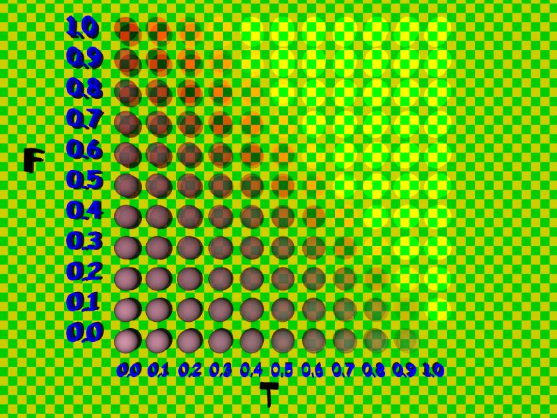

I was trial-and-erroring the other day with filter and transmit values
in rgbft, so I made this little chart to get an idea of what was going
on. Hope it helps.
Andy

This is great! But perhaps it would look better if the floor was less brightly
coloured. Try a darker yellow and green, or perhaps a single colour I don't
really know the result. Also perhaps you should change the lighting angle, it
is hard to tell which is the sphere and which is the shadow in the more
translucent objects.

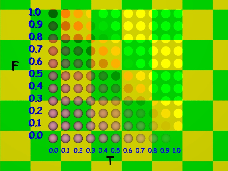

Or in this case perhaps no shadows would be useful.

 Here is a revised version, with no shadows and a larger size on the
checker. I left the checker in so that the effect of the transmit variable
would be more discernable than with a single color background.
Andy

Very cool, indeed. This is such a help, thanks for doing this.   ;-]

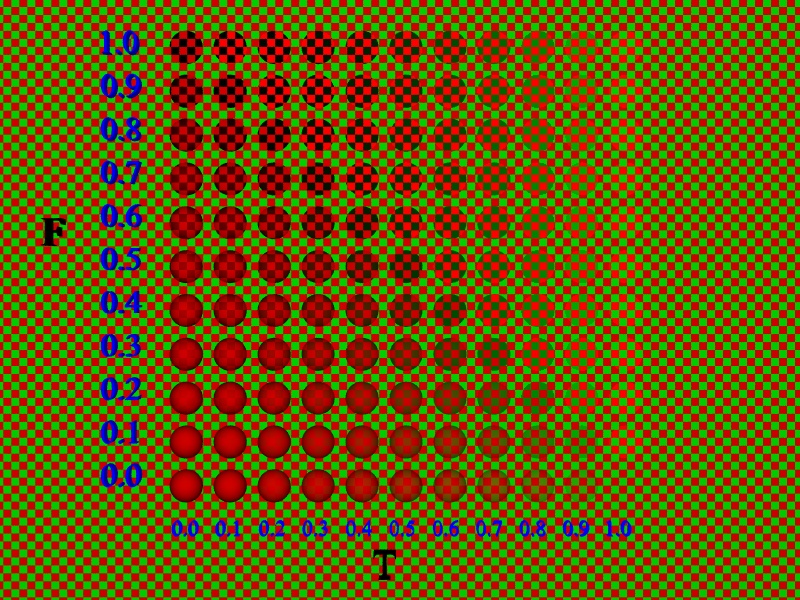

From: Andrew Woodfin
Subject: Re: Transmit and filter array
Date: 30 Apr 1999 19:30:25
Message: <372A2E2D.E1C00CC8@uncc.edu>
One more. Sorry about the filesize but tighter jpeg compression really
gummed the image up. This time the background is pure green and pure red, with
pure red spheres (e.g., pure red=rgb<1,0,0>). This helps to show the effect,
note where f=1.0 and t=0.0, the green checks are black since no green is
transmitted, but the red checks are indistinguishable from the rest of those in
the plane.
    Also of interest is the top right corner, where both values = 1.0; the red
value is intensified since the transmission imparted by each value adds.
    I apologize for the pattern's harshness to the eye, but it's more for
instruction than aesthetics. Also, the source is posted in p.t.s-f if anyone is
interested.
Andy

I think I'm loosing it.
The last post of yours I put in my NG/Uitls-Crack folder, but
this one totally baffles me.
Thank you for all the work that you have put into these
experiment's, I'm sure that it will help many of us progress more
steadily than we would have done without this valuable
information.
Steve

If someone ever asks about textures in POV-Ray these images would be a
great asset to help explain the difficulty in getting desired results in
such textures as those which contain filter and/or transmit.
Problem is that there are so many combinations, graphing them all would be
tedious if not impossible. Have you considered animating these? Then a
range of base colors could be seen incrementaly on a frame by frame basis,
essentially producing dozens of charts in a single animation.

From: Rikard Bosnjakovic
Date: 3 May 1999 12:20:29
Message: <372DBEA5.2816F884@hack.org>
When posting HUGE pictures like that, it's wise to type the imagesize in
the header or such. I don't care, because I'm on an ethernetconnection
at no cost at all, but there are modemusers (*g*) out there.
// Rikard Bosnjakovic - http://a214.ryd.student.liu.se/ - ICQ: 1158217
