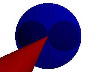

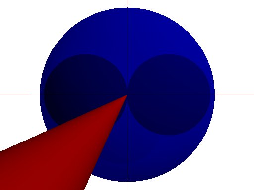

Will someone please tell me why the following code renders as it does?
(place a camera at <0,0,-12>)
sphere{<0,0,0>,5 pigment{rgbf<0,0,1,.5>}}
sphere{<0,0,0>,2.5 translate -2.5*x pigment{rgbt<1,1,0,.5>}}
sphere{<0,0,0>,2.5 translate 2.5*x pigment{rgbt<1,1,0,.5>}}
gives me the image attached.  now; is it me, or, shouldn't the edges of the
small spheres meet perfectly with the edge of the big sphere?  I say this is
a stupidity problem simply because, well, it's obviously something simple
i'm not getting.
Mike Metheny
lon### [at] vtedu
mik### [at] loneshepherdcom
http://www.loneshepherd.com/
"When one's words are no better than silence, one should keep silent."
Download 'problem.jpg' (13 KB)
Preview of image 'problem.jpg'

It's a question of perspective.
With, the camera setup the way it is, you are looking through a small
portion of the sphere in order to see the intersecting edges.
GrimDude

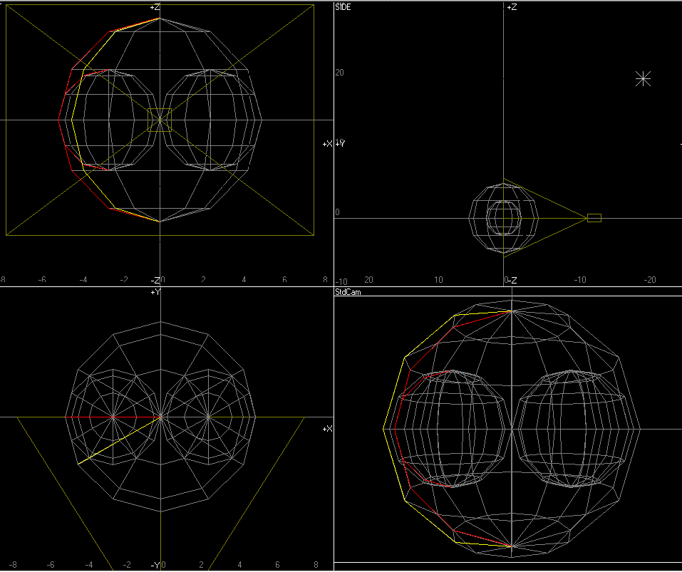

From: Johannes Hubert
Subject: Re: Stupidity problem
Date: 21 Apr 1999 03:47:17
Message: <371d7475.0@news.povray.org>
Sorry Ken, but you got your maths wrong here.
The spheres are scaled and translated correctly to give the expected result.
Actually, they *do* give the correct and expected result!
I agree with GrimDude: It is a problem of perspective.
The camera is so close to the outer sphere, that the near part is
perspectively magnified so much, that it appears larger than the X/Y-plane
"equator" which lies farther back (and where the sphere really *do* meet at
the edges as expected.
I attached a screenshot from Moray where I recreated the scene and then
marked the actual equator with red and the *percieved* outer edge with
yellow (front, side, top and perspective view).
So long,
Johannes.
Try to use the orthographic camera which would eliminate the perspective
problem. If I remember correctly I have had this problem myself. The
solution is no good if you want the perspective, but it is good to use
when placing things in relation to eachother.
/Johan
