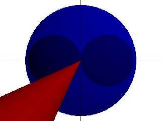

Will someone please tell me why the following code renders as it does?
(place a camera at <0,0,-12>)
sphere{<0,0,0>,5 pigment{rgbf<0,0,1,.5>}}
sphere{<0,0,0>,2.5 translate -2.5*x pigment{rgbt<1,1,0,.5>}}
sphere{<0,0,0>,2.5 translate 2.5*x pigment{rgbt<1,1,0,.5>}}
gives me the image attached.  now; is it me, or, shouldn't the edges of the
small spheres meet perfectly with the edge of the big sphere?  I say this is
a stupidity problem simply because, well, it's obviously something simple
i'm not getting.

From: Mike Metheny
Subject: Re: Stupidity problem
Date: 21 Apr 1999 02:52:08
Message: <371d6788.0@news.povray.org>
<< You are correct in assuming the misconception on your part was the key
 player in this little drama. A sphere represented as:
 sphere { <0,0,0>, 1 = a sphere "2" units across !!!
Yes I understand this Ken.  But is not a sphere, sphere{<0,0,0>,5} centered
by default at the origin?  So, it extends, 5 units up, 5 down, 5 left, 5
right, 5 in, 5 out.  it is completely centered.  Thus; by making a sphere
radius 2.5 (diameter 5) by translating it by it's radius to the right, the
left edge should be at the origin, and the right edge should be at 5,0,0
correct?  In this image it does not appear that way.

From: GrimDude
Date: 21 Apr 1999 03:08:04
Message: <371d6b44.0@news.povray.org>
It's a question of perspective.
With, the camera setup the way it is, you are looking through a small
portion of the sphere in order to see the intersecting edges.
GrimDude

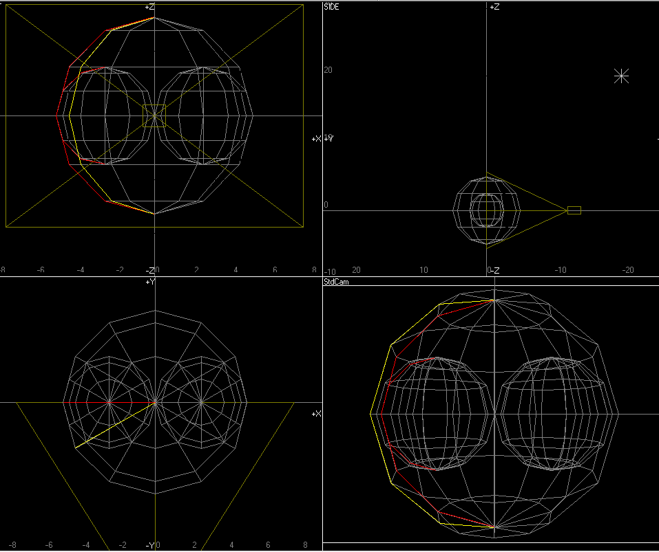

From: Johannes Hubert
Date: 21 Apr 1999 03:47:17
Message: <371d7475.0@news.povray.org>
Sorry Ken, but you got your maths wrong here.
The spheres are scaled and translated correctly to give the expected result.
Actually, they *do* give the correct and expected result!
I agree with GrimDude: It is a problem of perspective.
The camera is so close to the outer sphere, that the near part is
perspectively magnified so much, that it appears larger than the X/Y-plane
"equator" which lies farther back (and where the sphere really *do* meet at
the edges as expected.
I attached a screenshot from Moray where I recreated the scene and then
marked the actual equator with red and the *percieved* outer edge with
yellow (front, side, top and perspective view).

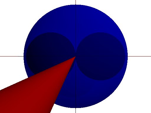

From: Johan Eriksson
Date: 21 Apr 1999 03:56:29
Message: <371D769B.BC1BE380@oc.chalmers.se>
Try to use the orthographic camera which would eliminate the perspective
problem. If I remember correctly I have had this problem myself. The
solution is no good if you want the perspective, but it is good to use
when placing things in relation to eachother.
/Johan
