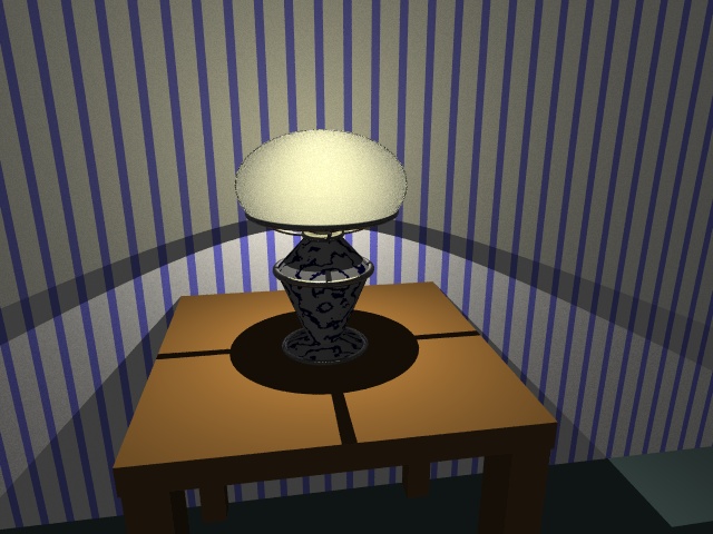

Here's a little scene to demonstrate using media to simulate translucency
(diffuse transmission). Dont' tell me the wallpaper, table etc. suck. I know
and right now I don't care. Just concentrate your gaze upon the lamp shade
and tell me what you think.
I had to use very dense media to get only diffuse light transmission (rgb
1500). This posed a bit of a problem, understandable when you read my post
about media_interaction (in .general). So there are actually 2 lamp shades:
one, the media container, with a clear filter and no_shadow to avoid the
shadow of the media (which would be nearly opaque in this scene); and
another, slightly thicker, using a yellowish filter to create the shadow you
see.
In the process, I encountered other quirks. Using a area light changes the
appearance of the media radically (much brighter and horribly grainy). Using
transmit also makes the media very grainy. I'm still exploring these
problems.

Hi Margus,
  I think you are on the right track if media is the choice you
prefer to model translucency with. I still think there are other
alternatives but I am not going to say what until I get a chance
to test my own theories. Your rgb values sound a bit whacko and
I don't understand why you would have to go so high with them.
In this business whatever works I suppose.
Ken's tip of the week:
   An interesting thing happens to media used inside a container if you
add an ior value to the interior statement that also contains the density
statement. I don't understand exactly what happens but it has a tendency
to polarize(?) the grain structure of the media providing a somewhat
smoother appearance. It might be worth trying with the media in this model
to see how different it is and if it behaves better or worse. I tried this
with a color list patterns study I did about a month ago and there was a
noticeable difference in how the density appeared. In the case of where I
used it the difference was better as it both smoothed the density of the
media as well as giving it better visibility in the lighting conditions
that were used.
  Your mileage may differ and some restrictions do apply. See your local
representative for details or answers to other questions you may have
concerning these restrictions and ways you may remedy them. Void where
prohibited or restricted by law. All rights reserved. No other conditions
apply whether implied or otherwise.
 Have a nice day :)
Ken Tyler

Ken wrote in message <37112AB4.43CC4E3C@pacbell.net>...
>Hi Margus,
I am appropriately intriqued, yet I respect your reserve and aspire to
contain my curiosity. Quite frankly, I can't imagine what alternatives you
have in mind (except bezier patches)
The scale of this scene is rather small and the walls of the shade are <0.01
units thick. So this value is by no means whacko. Anything less makes the
shade transparent (non-diffusively).
As for your tip: you are indeed correct. Adding ior to the media container
makes it much smoother. I already had ior in the outer (yellow) shade, but
this had no effect... Unfortunately, this also greatly changes the lighting
of the media, to something that is, in my opinion, incorrect. More
specifically, the top of the shade becomes extremely bright - possibly
because the light_source is closest to that part.
Yet another media mystery. I would VERY much like to know the explanation.
I will contact my solicitor for a detailed analysis of this statement and
any obligations, financial or otherwise, it may impose upon my person.
> Have a nice day :)
And a good night to you, kind sir!
Margus

While this is OK, I imagine that the rendering time is quite large... what I
was proposing is for someone to write a specific function for it... not only
would this be faster and easier to work with, it would also have no sampling
problems commonly associated with media...
Anyway, I think you're on the right track though and that's looking quite
good!
Now see if you can do this, a lit candle... :)
Lance.
