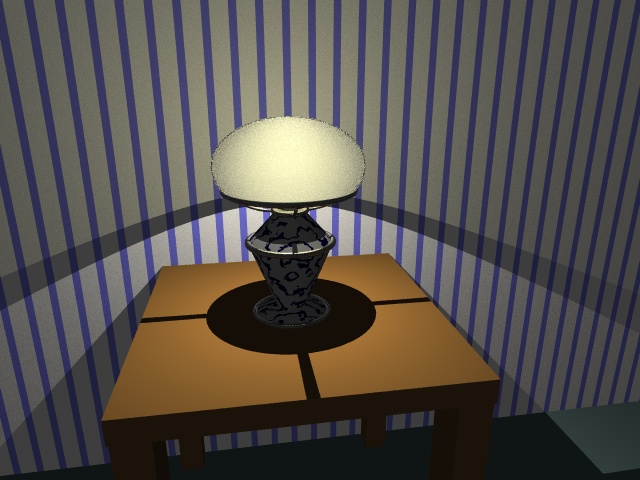

Here's a little scene to demonstrate using media to simulate translucency
(diffuse transmission). Dont' tell me the wallpaper, table etc. suck. I know
and right now I don't care. Just concentrate your gaze upon the lamp shade
and tell me what you think.
I had to use very dense media to get only diffuse light transmission (rgb
1500). This posed a bit of a problem, understandable when you read my post
about media_interaction (in .general). So there are actually 2 lamp shades:
one, the media container, with a clear filter and no_shadow to avoid the
shadow of the media (which would be nearly opaque in this scene); and
another, slightly thicker, using a yellowish filter to create the shadow you
see.
In the process, I encountered other quirks. Using a area light changes the
appearance of the media radically (much brighter and horribly grainy). Using
transmit also makes the media very grainy. I'm still exploring these
problems.
Margus

From: Margus Ramst
Subject: Re: Translucency demonstration (97 K)
Date: 11 Apr 1999 21:21:06
Message: <37113c72.0@news.povray.org>
Ken wrote in message <37112AB4.43CC4E3C@pacbell.net>...
>Hi Margus,
>  I think you are on the right track if media is the choice you
>prefer to model translucency with. I still think there are other
>alternatives but I am not going to say what until I get a chance
>to test my own theories.
I am appropriately intriqued, yet I respect your reserve and aspire to
contain my curiosity. Quite frankly, I can't imagine what alternatives you
have in mind (except bezier patches)
>Your rgb values sound a bit whacko and
>I don't understand why you would have to go so high with them.
>In this business whatever works I suppose.
The scale of this scene is rather small and the walls of the shade are <0.01
units thick. So this value is by no means whacko. Anything less makes the
shade transparent (non-diffusively).
As for your tip: you are indeed correct. Adding ior to the media container
makes it much smoother. I already had ior in the outer (yellow) shade, but
this had no effect... Unfortunately, this also greatly changes the lighting
of the media, to something that is, in my opinion, incorrect. More
specifically, the top of the shade becomes extremely bright - possibly
because the light_source is closest to that part.
Yet another media mystery. I would VERY much like to know the explanation.

From: Lance Birch
Date: 11 Apr 1999 22:56:48
Message: <371152e0.0@news.povray.org>
While this is OK, I imagine that the rendering time is quite large... what I
was proposing is for someone to write a specific function for it... not only
would this be faster and easier to work with, it would also have no sampling
problems commonly associated with media...
Anyway, I think you're on the right track though and that's looking quite
good!
Now see if you can do this, a lit candle... :)
Lance.

Do you like this implementation, Lance? This is part of my May-June
1997 entry, re-rendered in 3.1 (no halo). Check the IRTC archive, I've
posted source too (indented and commented :) ). HTH.
Peter Popov
ICQ: 15002700
Download 'CANDLE.jpg' (21 KB)
Preview of image 'CANDLE.jpg'
