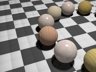

I figured it was about time to learn how to USE Povray rather than just
tinker with it :)
To that end I've been experimenting with camera settings, and I noticed a
problem. If you look at the two scenes below, the only difference between
them is the aperture setting on the camera ( 0.0 vs. 0.4 ), yet the image
with focal blur is 'washed out'. Both are using Radiosity ( standard setting
5 ) and an area light, and both have anti-aliasing set to 0.3 - although the
focal blur feature seems to disable this when the aperture is >0. Is there a
way to prevent this washout without turning all the lights down? I apologize
if I'm just missing some simple setting that's in the documentation, but I
can't find it ATM :) I'm impressed both with the level of realism that focal
blur and radiosity add to an image, and the hit my rendering time takes :)
Download 'camtest1.jpg' (12 KB) Download 'camtest2.jpg' (16 KB)
Preview of image 'camtest1.jpg'
Preview of image 'camtest2.jpg'

Yep, focal blur causes "wash out" alright, been brought up before. Not
sure if POV 3.1e has this fixed or not.

HMMM... the focal blur really works well here, but I wonder if you can
compensate for the wash out by lowering the assumed gamma of global diffuse and
brilliances of all the textures... just a thought tho I'm not sure if they'll
work

A good suggestion :) It works too - I put in...
#declare pov = <-6,6,0>;
#declare pof = <2.5,0.5,0>;
#declare arp = 0.2;
global_settings
  #if (arp)
        assumed_gamma 1.5
  #else
        assumed_gamma 1.0
  #end
camera
  location  pov
  focal_point pof
  #if (arp)
        aperture  arp
        blur_samples 20
  #end
  direction 1.5*z
  right     4/3*x
  look_at   pof
