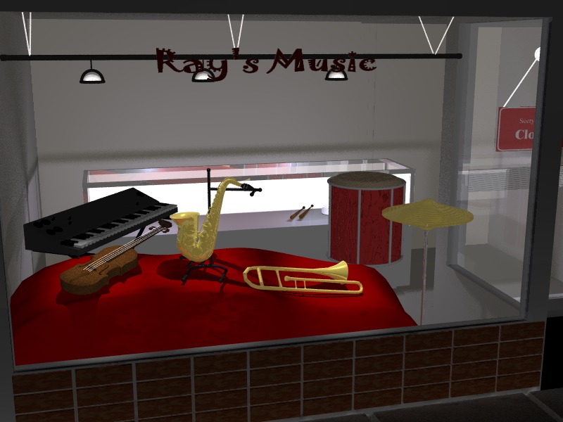

This is a semi final image. I plan on adding a few more objects and
tweaking the lighting/textureing but for all intense purposes this is
close to the final.
Download 'music store2.jpg' (87 KB)
Preview of image 'music store2.jpg'
From: bankspad
Subject: Re: Music 3 (87k)
Date: 9 Apr 1999 22:14:53
Message: <370EA1DB.E48A1F35@pacbell.net>
oh, now that turned out real nice.   ;-]
You mentioned in a previous post that you resolved your lighting issues; mind
sharing what you did?

From: Thomas Lake
Date: 9 Apr 1999 22:59:37
Message: <370EB1B9.AB0220E9@home.com>
Thanks!
Sure thing. It turned out to be a really silly problem, almost embarrassing, I
just had to turn the light's rgb value way down, all the way to 0.3. I just
didn't expect to have to turn it down so much. When I did however it fixed the
glarey affect the light in the other image had. However with the lower light
level I had to create a copy of the light and place it at the opposite end of the
counter.

From: Margus Ramst
Date: 10 Apr 1999 13:37:43
Message: <370f7e57.0@news.povray.org>
Nice modelling. However, I have some suggestions about the texturing. First
and foremost, the brass instruments. The texture should have a higher
brilliance value and the pigment should be darker. Perhaps also a bit lower
saturation and hue (I love HLS)
The sound-box (?) of the violin should look a bit more shiny and less noisy
<g>. Right now, I really don't see it as lacquered veneer.
Margus
Date: 10 Apr 1999 21:24:46
Message: <370FDBB5.8A5CFB8B@ndirect.co.uk>
This has come on leaps and bounds since the first version.  How
about a moth organ, recorder, malodica and some small percussion
instrumaents in the display case.
Maybe some small area lights above shaded objects such as the
keyboard, making it look asthough there might be a spot light
somewhere, but we can't quite tell where it is kind of thing.
Steve
