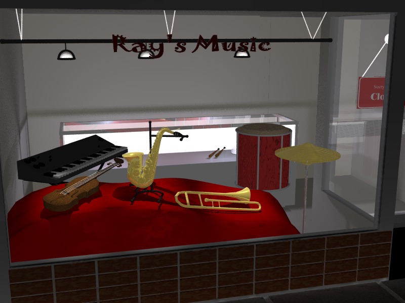

This is a semi final image. I plan on adding a few more objects and
tweaking the lighting/textureing but for all intense purposes this is
close to the final.
Download 'music store2.jpg' (87 KB)
Preview of image 'music store2.jpg'

oh, now that turned out real nice.   ;-]
You mentioned in a previous post that you resolved your lighting issues; mind
sharing what you did?

Sure thing. It turned out to be a really silly problem, almost embarrassing, I
just had to turn the light's rgb value way down, all the way to 0.3. I just
didn't expect to have to turn it down so much. When I did however it fixed the
glarey affect the light in the other image had. However with the lower light
level I had to create a copy of the light and place it at the opposite end of the
counter.

I have one problem with the image that maybe someone can help me with? Well
actually it isn't with the image rather the posting of it. When I compressed
it on my HD I used a setting of around 10%, 90% quality. This looked fine when
I viewed it on my HD but at soon as I saw the posting I noticed a ton of JPEG
artifacts particularly the circles on the back wall around the light. Is this
just my version of netscape, a setting in it, or do other people see this?

Nice modelling. However, I have some suggestions about the texturing. First
and foremost, the brass instruments. The texture should have a higher
brilliance value and the pigment should be darker. Perhaps also a bit lower
saturation and hue (I love HLS)
The sound-box (?) of the violin should look a bit more shiny and less noisy
<g>. Right now, I really don't see it as lacquered veneer.

This has come on leaps and bounds since the first version.  How
about a moth organ, recorder, malodica and some small percussion
instrumaents in the display case.
Maybe some small area lights above shaded objects such as the
keyboard, making it look asthough there might be a spot light
somewhere, but we can't quite tell where it is kind of thing.
