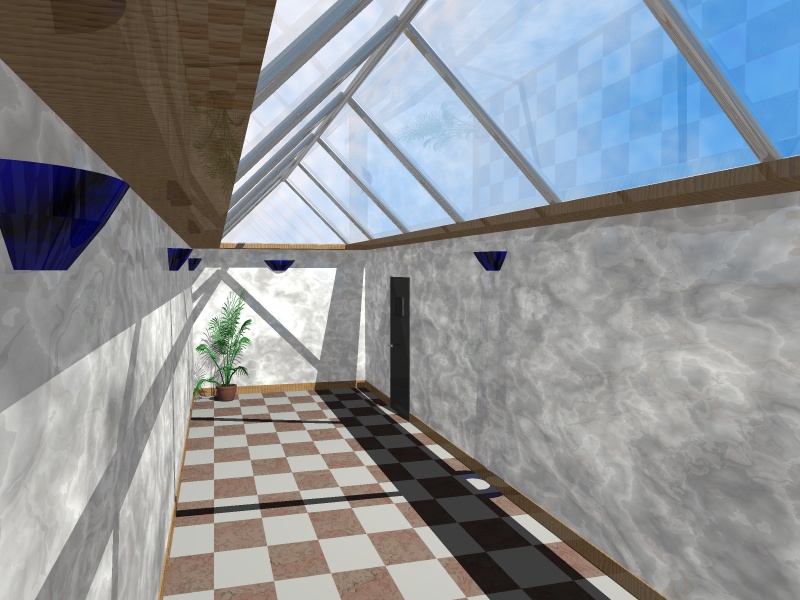

As the title indicates, here it is.  This is a scene I'm working on for
a computer game.  It's not finished yet, obviously.  It's actually a
hallway in a hospital in the future.  Like the plant?  I'm not sure what
to do for the wall texture.  By the way, would this image benefit in any
way from Nathan's photon patch?  Just curious.  DOH!! I just noticed
this, it looks like that ledge on the right side wasn't quite up against
the wall, There's a bunch of light streaming in behind it!  man that
stinks...
Any suggestions?
		Kyle
Download 'halway.jpg' (161 KB)
Preview of image 'halway.jpg'

  I doubt it would benifit from the use of photons. The use of radiosity
on the other hand is suggested. Photons are better reserved for situations
where there is likely to be refracted light passing through a substance.
Flat panel glass has little if any refraction value. Flat panel glass with
water sandwiched inside like an aquarium would be a better example when to
use it as would prisms, drinking glasses, and hand blown glass works.
 Nice plant.
Ken Tyler

Yeah, I didn't think it would really.  I had tried a rendering w/
radiosity but strangely, didn't see a difference really.  Maybe I'll try
that again.  You like the plant!  You really like the plant!  I knew it
was a winner :-)  Thanks for the comments Mr. Tyler.
		Kyle

I'm going to make some suggestions to my own pic.  I think it needs some
more *plants* :-)  I think I'll try to put some ivy looking stuff up on
top of those ledges.  Yeah, that's the ticket.  And um... then I'll try
to render it w/ radiosity, and I'll fix that ledge on the right.  Then,
after that, I'll make those white tiles a little bit whiter.  Then, I'll
put in a nice food cart w/ some green jello and rubbery salisbury steak
on a plate.  Anything I'm missing?

Did you mean for the wood beam on the left to be reflecting the floor
and
cool plant? It looks as though the beam is supposed to be roughly cut
which
of course wouldn't reflect much if anything.Unless it's shellacked; I
had a bar
in the basement of the last house I lived in. The boards were cut very
roughly
and then about an 1/2inch(no kidding...I didn't build it)of shellac was
applied
over the top to make it smooth...

BTW I think that the ledge on the left, is made of wood, isn't it, so made
be it should be less reflective (hard to polish every day !)
Philippe

I have a couple of suggestions:
For the walls, perhaps scaling the "marbeling" down to be just a smidge
tighter, and then breaking up the walls with panel marks, then rotating the
texture just a hair on every few panels. Since the scene is based in the
future, perhaps some monitoring epuipment embedded in the walls, sliding
panels, comp. interface, holograph x-ray view screen. I really like the plant.
Maybe instead of being "potted" it could be set up for hydroponics, set into
an inset in the wall with grow lighting and an environment control panel
and ... and ... and ...
Well, if nothing else, your image definetly encourages the imagination.   ;-]
 Thanks for the suggestion for the wall, I think that'll look MUCH
better.
Ahh yes, computer screens, can never have too many of those :-)
I knew you would like the plant, everyone likes the plant.
> I hope I didn't overspeak myself.
Not at all. I like criticism.
	Kyle

Oh, you like the plant?  Well, it was just a little something I threw
together...:-)
I did mean for the beam to be reflective, no good?  Is wood highly
polished in the future?  I'm not sure.
Maybe I'll tone it down just a bit.  Thanks for the suggestions :-)
		Kyle
