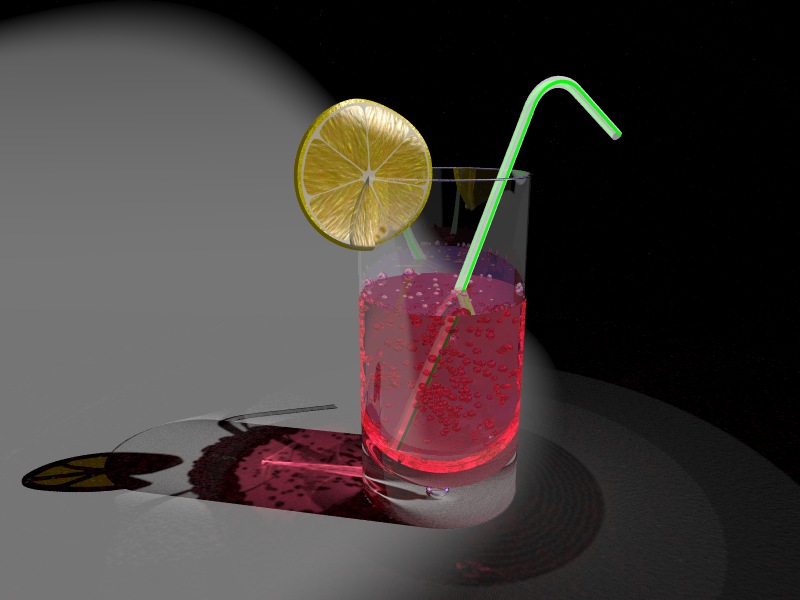

I'm not quite happy with the lemon, any suggestions?

Ah, refreshing. And refreshing picture too!
See you even added a air bubble in the base of the glass.
The lemon slice is good, think it's just the fact it's such a perfect
looking slice is all.
You could have used a turned up liquid edge inside the glass there,
appears kind of flat. The gas bubbles are really neat, though having
them diferenced from the drink would help (unless you did this already)
and/or get the ones along the sides to be apart from the liquid.
Summer-time, summer-time, sum-sum-summer-time...

when you think ( or wish ) you can just reach in and steal a quick sip -
then you know you've done a good job. I hope you don't mind, but I'm
keeping this one as wallpaper for hot summer days. ;-] The lemon is
beautiful. The only thing I can think of that keeps it from looking like
a photograph is that the slightly flipped part at the top of the slice
is too smooth. I'm wondering if a height field could be used for the
pulp - that and the pulp could look a little more "wet".
The lemon... hmmm...
it's probably the highlight on the folded part of the lemon. Try making
the phong or specular (whichever you use) highlight much more focused.
Also consider making the 'cells' of the lemon less transparent. Someone
also suggested a height field, use it just on the cells.
The rest of the picture looks excellent. The bubbles are a nice touch.

Surface perturbations, moisture, and some variation in the segments would
help.
Excellent work here.

Thanks all,
I try a heightfield and fiddle around some more with the highlight.

Some of the shadows are completely black (esp. that of the lemon thru glass
part and the upper part of the liquid). Perhaps you the max_trace_level too
low?
The lemon is nice. A strong bumpmap should be all it needs.

Margus Ramst heeft geschreven in bericht <3707c1dd.0@news.povray.org>...
>low?.....
I tried a higher max_trace, went from 25 to 100. There is no visual
improvement. Some arithmic in PSP showed almost no differences and mainly on
the outlines (from the AA calculations?). Only result, everything in the
stats is higher, even priority queue removed.

I still think there's something wrong here. The lemon thru glass shadow in
particular. It shouldn't be so dark (completely opaque?) unless perhaps the
glass had a ridiculously high ior - and it doesn't. Max_trace of 100 is
certainly an overkill (so is 25 in the glass/lemon case), so the problem lies
somewhere else.
Does it look the same even without photons / in official POV?
As for the stats - lack of patience sure isn't one of your shortcomings :)

Without photons there is no dark part in the shadow of the lemon, neither is
there a shadow of the glass.
