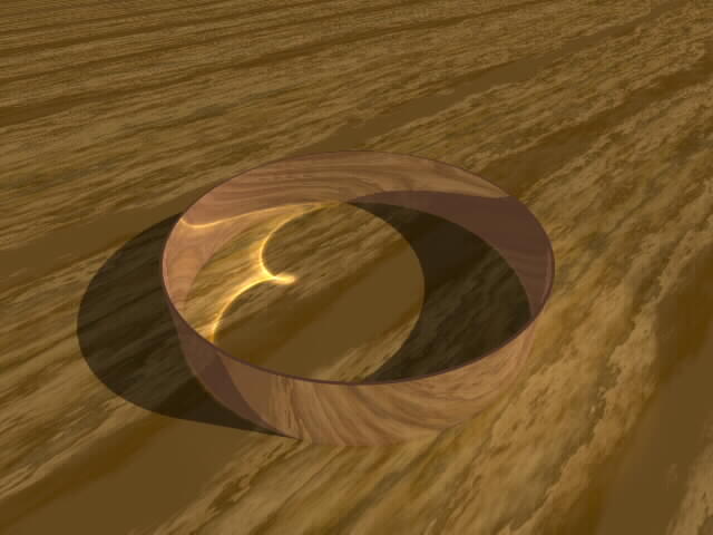

This is my feeble attempt at recreating Henric Wann Jensen's cool "classic
cardioid" caustic pattern (http://www.gk.dtu.du/home/hwj/ and
http://www.gk.dtu.dk/home/hwj/pictures/metalring.jpg) using Nathan Kopp's
Photon Patch for POV-Ray (http://www.nathan.kopp/photons.htm).
The problem with this (did I say feeble) attempt, is that as you can see,
the ray's are almost focused, but not quite. This is simply because the
light source is a skosh too high (as you can also see when you compare the
length of the shadow behind the object with the shadow in HWJ's version.
But... if I try to bring the light up any higher, all of the caustics
disappear.
I've posted the scene file in povray.text.scene-files if anyone would be so
kind to have a look.
By the way, I can see why HWJ used a wood-grain table setting. It really
does bring out the caustic effect. I just grabbed one of the standard wood
textures from the POV includes, but it gives the desired effect.
Download 'DavesRing.JPG' (26 KB)
Preview of image 'DavesRing.JPG'

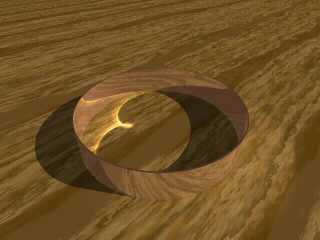

The problem will probably be corrected if you increase the 'autostop' angle.
Set it to 45 (degrees) and things should work.  Soon I'll have a FAQ that
explains this.
-Nathan

Thanks Nathan (and let me join the line of appreciative users of your
patch)! Here's the resulting image, and I've posted the source as a followup
in povray.text.scene-files. I have to humbly admit that I'm a little unclear
on what's going on with the photon parameters. I'll be looking forward to
your FAQ.
