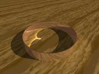

This is my feeble attempt at recreating Henric Wann Jensen's cool "classic
cardioid" caustic pattern (http://www.gk.dtu.du/home/hwj/ and
http://www.gk.dtu.dk/home/hwj/pictures/metalring.jpg) using Nathan Kopp's
Photon Patch for POV-Ray (http://www.nathan.kopp/photons.htm).
The problem with this (did I say feeble) attempt, is that as you can see,
the ray's are almost focused, but not quite. This is simply because the
light source is a skosh too high (as you can also see when you compare the
length of the shadow behind the object with the shadow in HWJ's version.
But... if I try to bring the light up any higher, all of the caustics
disappear.
I've posted the scene file in povray.text.scene-files if anyone would be so
kind to have a look.
By the way, I can see why HWJ used a wood-grain table setting. It really
does bring out the caustic effect. I just grabbed one of the standard wood
textures from the POV includes, but it gives the desired effect.
Download 'DavesRing.JPG' (26 KB)
Preview of image 'DavesRing.JPG'

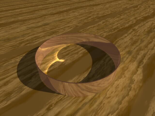

From: Nathan Kopp
Subject: Re: Caustic reflection problem
Date: 23 Mar 1999 10:47:52
Message: <36F7B744.D92F3465@Kopp.com>
The problem will probably be corrected if you increase the 'autostop' angle.
Set it to 45 (degrees) and things should work.  Soon I'll have a FAQ that
explains this.
-Nathan

Thanks Nathan (and let me join the line of appreciative users of your
patch)! Here's the resulting image, and I've posted the source as a followup
in povray.text.scene-files. I have to humbly admit that I'm a little unclear
on what's going on with the photon parameters. I'll be looking forward to
your FAQ.
