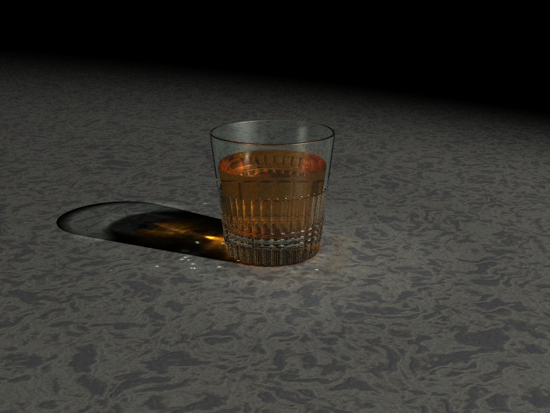

OK, you've already seen caustics with blobs, trees, birds... But have you
seen the caustics of a fine glass of liquor...? You have? Well, have some
more!
This damn thing took 30 minutes to parse and 17 hours to trace on my
PII416/64MB - mainly because reflections, but also because I turned on
reflected caustics on the glass (you _can_ see them, can't you?). Also, AA
had to be set to 0.1
For my next feat, I'll add some ice cubes (with media interior, reflections
and caustics), add reflections/reflected caustics to the whiskey and remove
"ignore_photons" from the glass. Then I'll take a nice 3-year vacation in
Burundi and hope to see it ready when I get back...
The glass itself is simple CSG, needs some work. I feel there is something
wrong with the refractions (at least upper part, where top of the wiskey
meets the glass).
It used 481,317 photons (overkill?), density .015, radius .15,2,.15. Whiskey
had refraction on, the glass had refrection & reflection on and
ignore_photons set.
I can only hope that the bright splotches are caustics from the
ornamentation on the glass.
Margus

Looks great!  Nice modeling on the glass.
Those bright splotches don't look right (I don't think I've seen anything
like that in reality).  They may be a bug.  Any chance you can email me
(or post) the code?
The reflective caustics do add a nice touch to the scene.  400k photons
is not too much for a scene (probably overkill for this particular scene,
though).  I am surprised at the parse time (since that's basically spent
shooting photons) and the render time for that matter... how high did
you set your max_trace_level?
-Nathan

From: Equiprawn
Subject: Re: Caustics, caustics...
Date: 17 Mar 1999 18:26:25
Message: <36f03a21.0@news.povray.org>
Hi,
Yes! Don't worry, I can see them.
>meets the glass).
I might know what this is. If you fill a clear glass with water, and look at
the top where the water's surface meets the glass, you will see that the
surface doesn't stay flat, but in fact curves up slightly. This happens
because of water tension, and in fact happens with all liquids, AFAIK. The
only exception I know of is liquid mercury, which curves down instead of up.
Very nice image!
Equiprawn
From: Margus Ramst
Date: 17 Mar 1999 19:46:18
Message: <36f04cda.0@news.povray.org>
Equiprawn > wrote in message <36f03a21.0@news.povray.org>...
at
up.
No-no, that's not what I meant (the whiskey surface actualy _does_ curve,
BTW)
I meant that there shouldn't be such a big gap between the inner surface of
the glass and the whiskey; I have modeled quite a few glasses (and stared at
them them in Real Life :) and they look different.
Let's see if I can explain this... Beacause of refraction or total internal
reflection, the walls of the glass should look very thin, i.e. the colour of
the liquid should extend all the way to the outer surface of the glass, even
if the glass is quite thick. The fact that the liquor in my image is so
clearly separated from the outer surface of the glass gives the impression
that the glass doesn't refract...
Hope you undesrtood. If not, feel free pour yourself a drink and check it
out. It's Black Velvet whiskey, if you want a precise test ;)
Margus
From: Nathan Kopp
Date: 17 Mar 1999 22:13:44
Message: <36F06F19.FC68902@Kopp.com>
Usually, I make the liquid a bit bigger than the interior of the glass.
Here's a cross-section:
++++ = glass
**** = liquid
#### = both
In other words, the liquid & glass overlap a bit.  Try it and see if
it works.
-Nathan
Date: 18 Mar 1999 08:03:11
Message: <36F0F77F.B3FE3580@ndirect.co.uk>
Can't wait to see the version with the ice cubes, I like this a lot, but
if I had created it I'd be a bit worried about the bright white
reflections/refractions on the floor.
Steve

From: Margus Ramst
Date: 18 Mar 1999 10:04:09
Message: <36f115e9.0@news.povray.org>
Nathan Kopp wrote in message <36F### [at] Koppcom>...
I can't see why it should be better. Surely the reverse holds true in
nature. In raytracing terms - overlap or not, the surfaces are nearly
coincident so the change in reflection/refraction vectors should be
negligible. And I have gotten correct results with the liquid smaller than
the glass.
Anyway, I'll try. But if this works better, I'd like to know why...
Margus

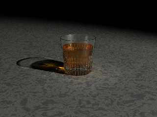

Ahh, I see what you mean now. You're right, it does look a bit strange. A
bug in Povray?
Equiprawn
