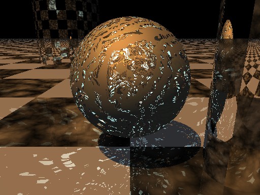

Hello All. I have no clue in this. Is there any way to 'soften' the light
projected onto the floor? I tried Media, interior and radiosity in global
settings, but the difference was not relevant. (Maybe I took the wrong
parameters., I would not be surprised!)
 I also tried to set more
lights in order to attenuate the main light, which is inside the spheres.  I
have also thought about changing the floor, but that's is not the goal. Can
you enlighten me, please?
Thanks in advance.
PS. I am posting the code in  binaries.scene.files

Go with area_lights and I think you'll have a winner.
You will most likely need 3 of them, one for each axis. Be forewarned,
it will get slow.
An alternative would be a filtering along the edges of the texture
boundary where the light gets through, or is it a object-only there
where the light gets out?
Look like refraction to me so the texture idea could work.

Thanks Bob, I will try them in this image.
