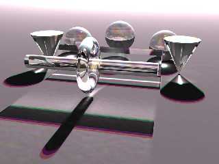

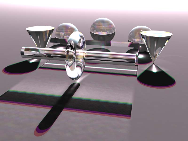

Instead though I have two other images that I rendered last night. The first
is a modified scene that comes with Povray. I just added the photon info.

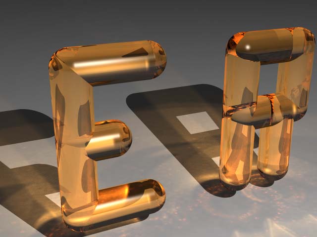

The second is of two glass letters ER, a merge of cylinders and spheres. I
made a scene about a year ago that used Povray's caustics on blob based
versions of the letters, but when I converted the scene to Photons, the
caustics didn't render. Has anybody else had problems getting blobs and
photons to work?
