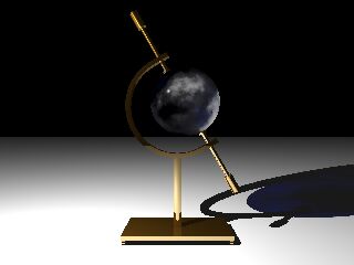

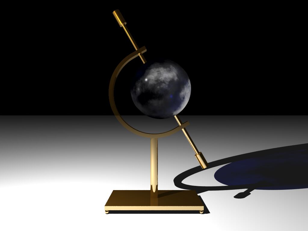

Hello,
Got an idea from work, so I thot I'd make it.  2nd decent pic of mine, so
thot I'd post it.  Any comments welcome.
Cman
Download 'globeonstand.jpg' (36 KB)
Preview of image 'globeonstand.jpg'
Subject: Re: Globe on Stand (37k)
Date: 14 Feb 1999 08:24:53
Message: <36C6CE6E.E36E9C3D@aol.com>
The infinite plane creates a false filtered look to the stand via
reflection, if you limit the dimensions to different front to back
distances this will offset it.
Like the look of these two objects, globe seems fractured with fog and
stand is a beautiful example of metal.
"Colorman (Kraxmel)" wrote:
> Hello,
> Cman
 mailto:inv### [at] aolcom?PoV

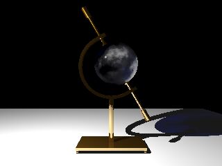

From: Colorman (Kraxmel)
Date: 15 Feb 1999 09:48:15
Message: <36c833af.0@news.povray.org>
Thanks for taking the time to explain!!!
I did notice the line there (more so after your post), and it really
bothered me.  I just thot it might be a glich in the program or something
that caused the line in the horizon from the plane to show up in the stand,
but now I understand AND it makes sense!!!
I tried what you suggested, and it was much better!  I also tried a box
instead of the plane (<-12,2,-12>,<12,0,12>), and except for the stand not
standing out as much, I like it better.
Neways, thank you very much for the help!!!  I learned something from it!
Cman

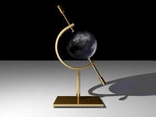

Date: 15 Feb 1999 11:14:37
Message: <36c847ed.0@news.povray.org>
I tried it, and it really looks better.  (Its attached)
I ended up going with Bob's suggestion of the clipped plane and put a white
sphere behind the camera, and played with its radius till it looked ok.  It
did white out some of the stand just a little bit, but I am not too
concerned with that (I would guess if I moved it back some it wouldn't do

Ken wrote in message <36C83678.57539086@pacbell.net>...
stand,
not
>> Cman
>There are times a reflective metallic surface like that can bennifit
>in appearence from having an object, wall, or what ever back behind
>the cameras position. The color black does little to add it self to
>reflective objects. I like using a large white sphere or cylinder.
>The curvature of the surface makes it so it doesn't reflect as an
>object in the back ground but will add it's color to the scene like
>a photographers backdrop or shaded fill lights will. Try it and you
>will see a whole new metallic object before the camera you didn't
>know you had.
>Ken Tyler
>mailto://tylereng@pacbell.net
Download 'globeonstand.jpg' (8 KB)
From: Ken
Date: 15 Feb 1999 11:24:42
Message: <36C849F1.15406D94@pacbell.net>
> that as much).
> Anyways, thanks for all the info!!!  I really want to learn POV-Ray (I even
> printed the manual - all 320 pages :).
> Cman
...out of the darkness of night it came proud and statuesque.
Really does bring out a metal finish. Now all you need to do is add a finish
statement to that white plane you are using. Since you are new you probably
don't know that Pov has a default finish for objects that don't have one
assigned by the user. I thinkd the defaults are diffuse 0.7 and ambient 0.2.
That diffuse value of 0.7 is really high in my opinion and can be seen in
evidence by the near halo like glow coming from the bright spot on the floor.
Try something like:  finish{ambient .3 diffuse .35}
This will mellow it out some and put more focus on the object and not the
bright spot in the image.
Cheerio,
Ken Tyler

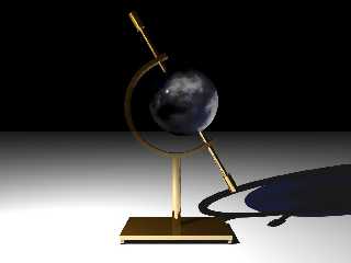

Date: 20 Feb 1999 09:11:03
Message: <36cec277.0@news.povray.org>
Ya know...I see the difference, but the whole scene looks
faded/darker/hazier (don't know the right word I am looking for) now.
Almost blurry.
Anyways thanks for the lession.
I am working on a model of a kenetic energy thing I have at work.  It runs
on battery and just spins and spins and spins and .....  Someone at work
said, "be neat if you could animate it."  I said, "I will!!!"  Provided I
can get it to work, it'll be up later this weekend.
Cman
