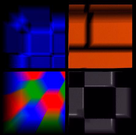

   The images shown here are an example of media using the 3 color list
 patterns in Pov. The pattern types are Brick, Checker, and Hexagon.
 The first image is shown with no back ground. The second smaller image
 has a mostly dark plane behind it to illustrate the fourth checker
 pattern object more clearly. The reason for exploring these density
 types comes from a question on c.g.r.r. about not being able to use
 color list patterns in a media statement. I think I have resolved
 that issue completely.

 4.) In each example there is a common element. That is all save one had
     the exact same media modifiers used such as samples, intervals,
     confidance, and media type. The one that was different can be seen
     in the lower right of the image and that used two media statements.
     One is an emmission media while the second is an absorbing media.
     Both used the checker pattern in the density statements.
  The different density types are as follows:
  Image Lower  Left  - Hexagon Pattern
  Image Lpper  Left  - Checker Pattern
  Image Upper Right  - Brick   Pattern
  Image Lower Right  - Checker Pattern / with emmiting and absorbing medias

  The only difference between the two images is the addition of a background
  plane for the second image to show the emmission/absorbsion object better
  and the checker was scaled to make it more visible.
