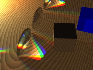

Someone requested an update on the photon mapping patch.  Here's a pic.  :)
Here we see three lenses lit by three light sources.  The middle lens
has photon mapping turned off (the default), so it casts normal filtered
shadows just like any other object.  If you look on the blue box, you'll
see light reflected from the bronze box.  There's also some light reflected
from the bronze box that goes through the lens nearest to the camera.
Image stats:
aa: 0.3
render time: 3:25
number of photons: 67,968
peak memory used: 3,004,062
-Nathan
Download 'test1b.jpg' (21 KB)
Preview of image 'test1b.jpg'

>There's also some light reflected from the bronze box
Am I to understand you can also do caustics from secondary light sources
(caustics from caustics)?!

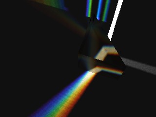

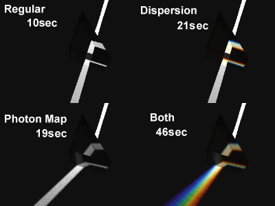

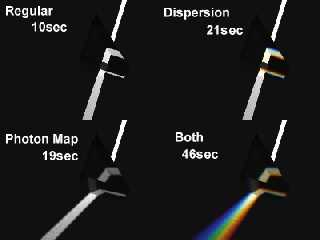

The rgb caustics come from three lights in different positions.  This does
do wavelength dependent ior, too (images attached).  Instead of sampling
the spectrum randomly, I allow the user to give a list of wavelengths
(in the form of RGB vectors) that make up the light.  I use a modified
version of Daren Wilson's dispersion patch, along with your rgb->hue
conversion function to do the rest.
-Nathan

From: Mike
Subject: Re: Lenses
Date: 1 Mar 1999 23:43:59
Message: <36DB796D.2931E516@aol.com>
I didn't think you'd be able to do something like THAT.  45 seconds?
Wow!
-Mike
