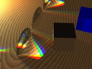

Someone requested an update on the photon mapping patch.  Here's a pic.  :)
Here we see three lenses lit by three light sources.  The middle lens
has photon mapping turned off (the default), so it casts normal filtered
shadows just like any other object.  If you look on the blue box, you'll
see light reflected from the bronze box.  There's also some light reflected
from the bronze box that goes through the lens nearest to the camera.
Image stats:
aa: 0.3
render time: 3:25
number of photons: 67,968
peak memory used: 3,004,062
-Nathan

>There's also some light reflected from the bronze box
Am I to understand you can also do caustics from secondary light sources
(caustics from caustics)?!

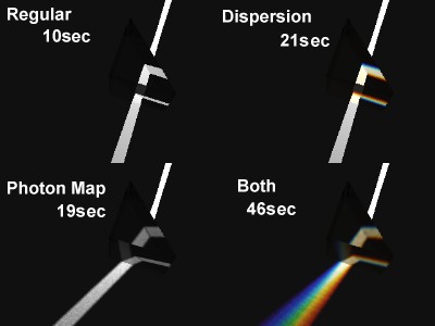

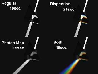

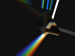

From: Nathan Kopp
Subject: Re: Lenses
Date: 28 Feb 1999 20:11:46
Message: <36D9E946.74261F86@Kopp.com>
ivfer wrote:
> 1) Did you ever solve the problem with splotchiness when firing random
> photons? If you're still using a scanning approach do you handle the case
> where an object surrounds a photon source? You'd need to scan based on
> spherical coordinates in that case.
No.  I use a jittered uniform scan.  And I always use spherical coordinates.
That way it provides even distribution of photons on the surface of a
sphere centered on the origin, which is more physically accurate (as
opposed to evenly distributed on a planar surface).
> 2) Are you using wavelength dependent ior or are the r,g,b caustics due to
> different positions of the lights? If you're doing wl-dependent ior, how do
> you encode the light's spectrum in the photon? I punted and simply fired
> multiple single-wavelength photons (jittered spectrum sampling) if the
> target had a wl-dependent ior (and prayed that subsequent objects weren't
> wl-dependent).
The rgb caustics come from three lights in different positions.  This does
do wavelength dependent ior, too (images attached).  Instead of sampling
the spectrum randomly, I allow the user to give a list of wavelengths
(in the form of RGB vectors) that make up the light.  I use a modified
version of Daren Wilson's dispersion patch, along with your rgb->hue
conversion function to do the rest.
-Nathan
Download 'prism.jpg' (16 KB) Download 'prism2.jpg' (8 KB)
Preview of image 'prism.jpg'
Preview of image 'prism2.jpg'
